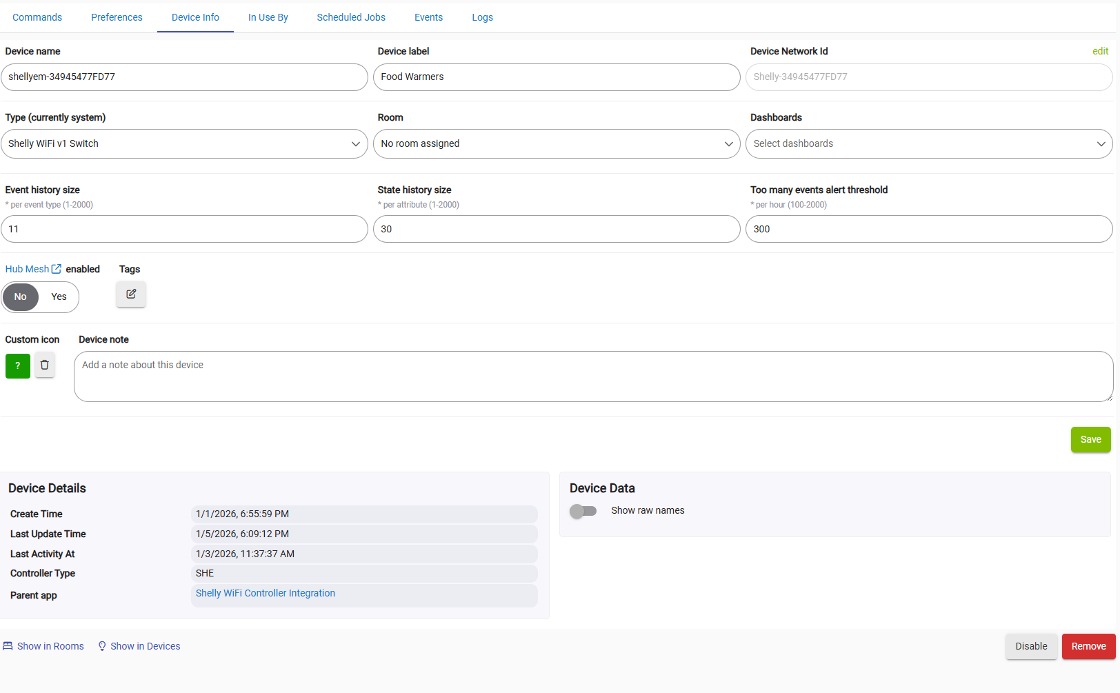

I have these
Shelly EM + 120A + 50A Clamps
I changed the device type to Shelly WIFI Switch V1 from Shelly WIFI Device now most the the unrecognized device types are not there. I am not sure what device type I should have selected?
The Shelly EM+ is not a switch. It is a power monitor with a relay (I think). It looks like you might need a community driver to run these properly. You could check out this post (It mentions a diver for the EM, not sure if that includes the EM+): [RELEASE] Shelly Device Drivers (NO MQTT NEEDED)
This fixed my issue! Thank you
