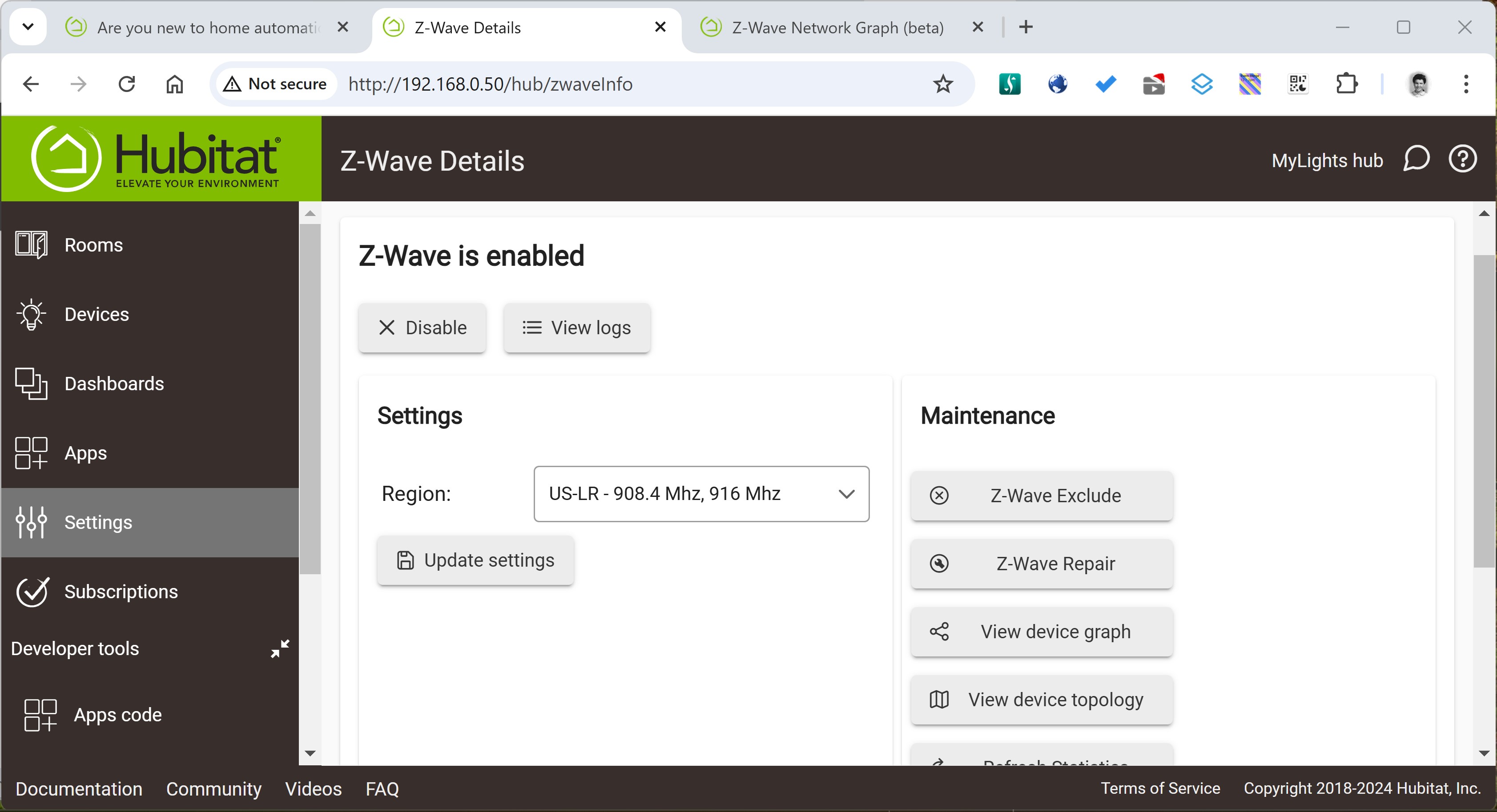

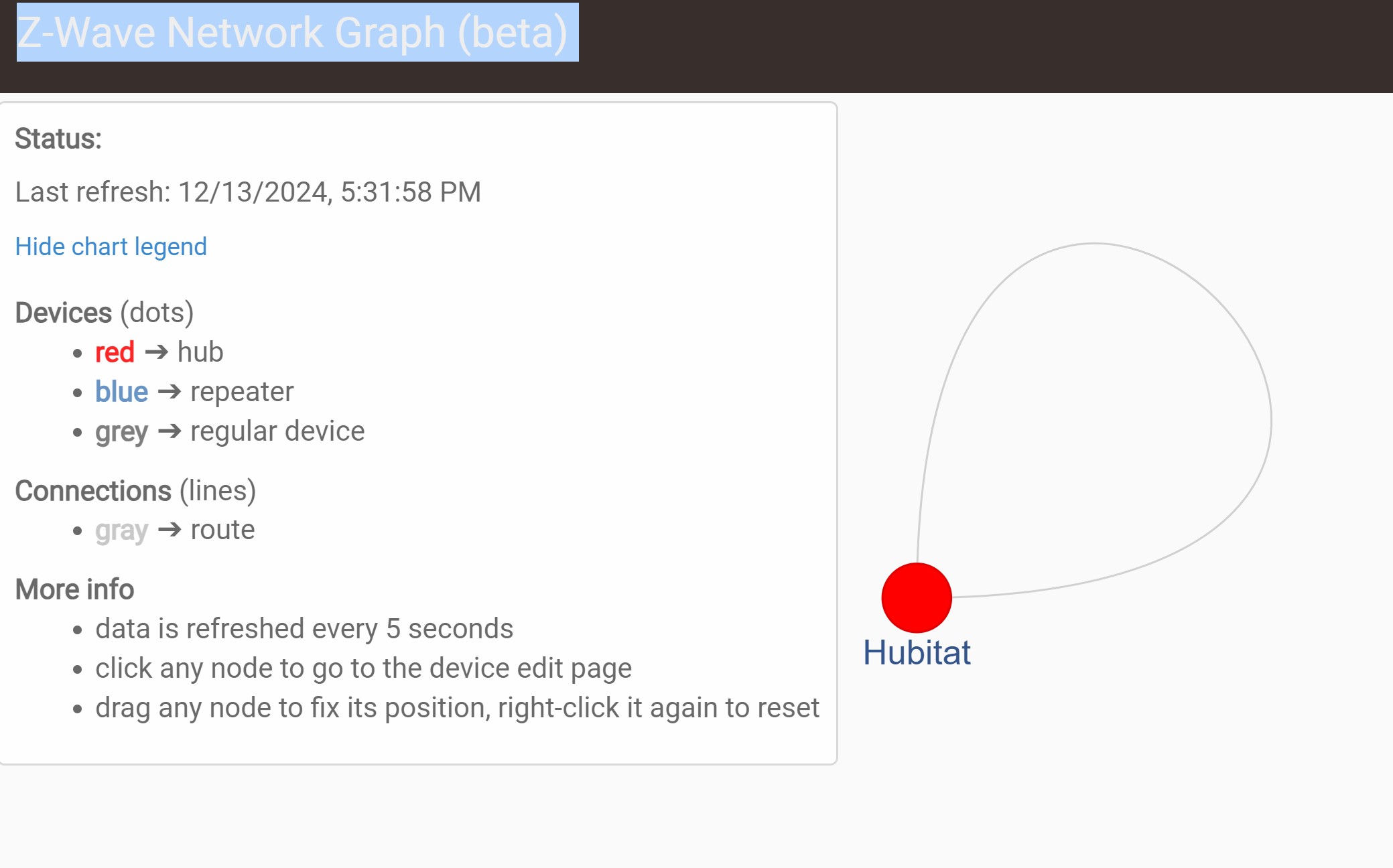

What does your Z-wave details page show?

Screenshot of zwave details.

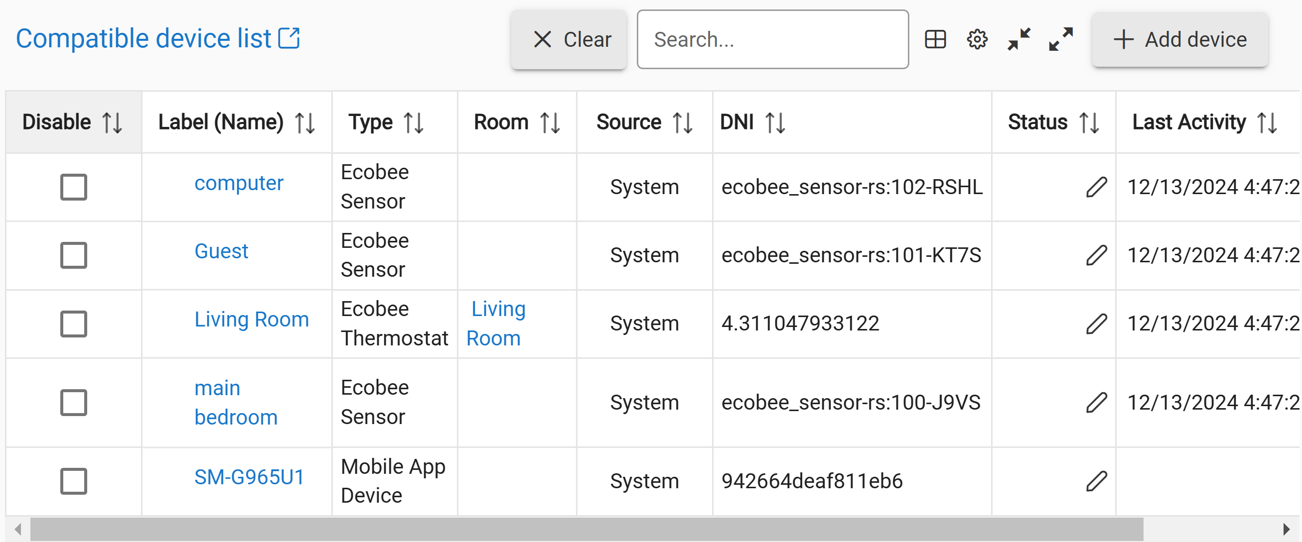

The following is creenshot of my devices
The only devices listed are ecobee devices which came in from the Amazon skill app and my phone with the mobile app on it .

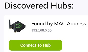

I must be doing something fundamentally wrong. I use the pin in the back to reset the hub. The LED blinks blue for about 5 seconds then turns green.. The hub doesn't get discovered until I do an advanced search on the MAC address. It returns a "found by MAC address" almost instantly.
However, clicking on the "Connect to Hub"button returns a network error:

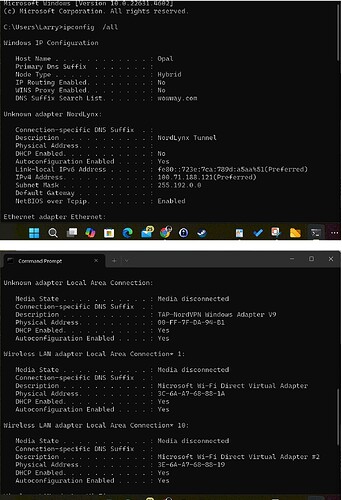

What is the IP of the PC you are trying to connect to the hub from? Open a command prompt (search for cmd and open), and run ipconfig. You are looking for an IPv4 Address that starts with 192.168, it should be 192.168.0.X. If it is anything other than .0 subnet then you must have multiple subnets or DHCP servers on your LAN.
This error leads me to believe you have other networking problems on your LAN, that is not a normal error message.
Did you try opening a browser window and just browsing to http://192.168.0.50 (the IP shown for the hub)?
You could also try doing this from your phone connected to the Wifi (hub still on ethernet) and see if you have better luck there. There could be some configuration issue on your PC preventing it from reaching the hub,

My Ethernet is 192.168.0.71 WiFI is 192.168.0.40

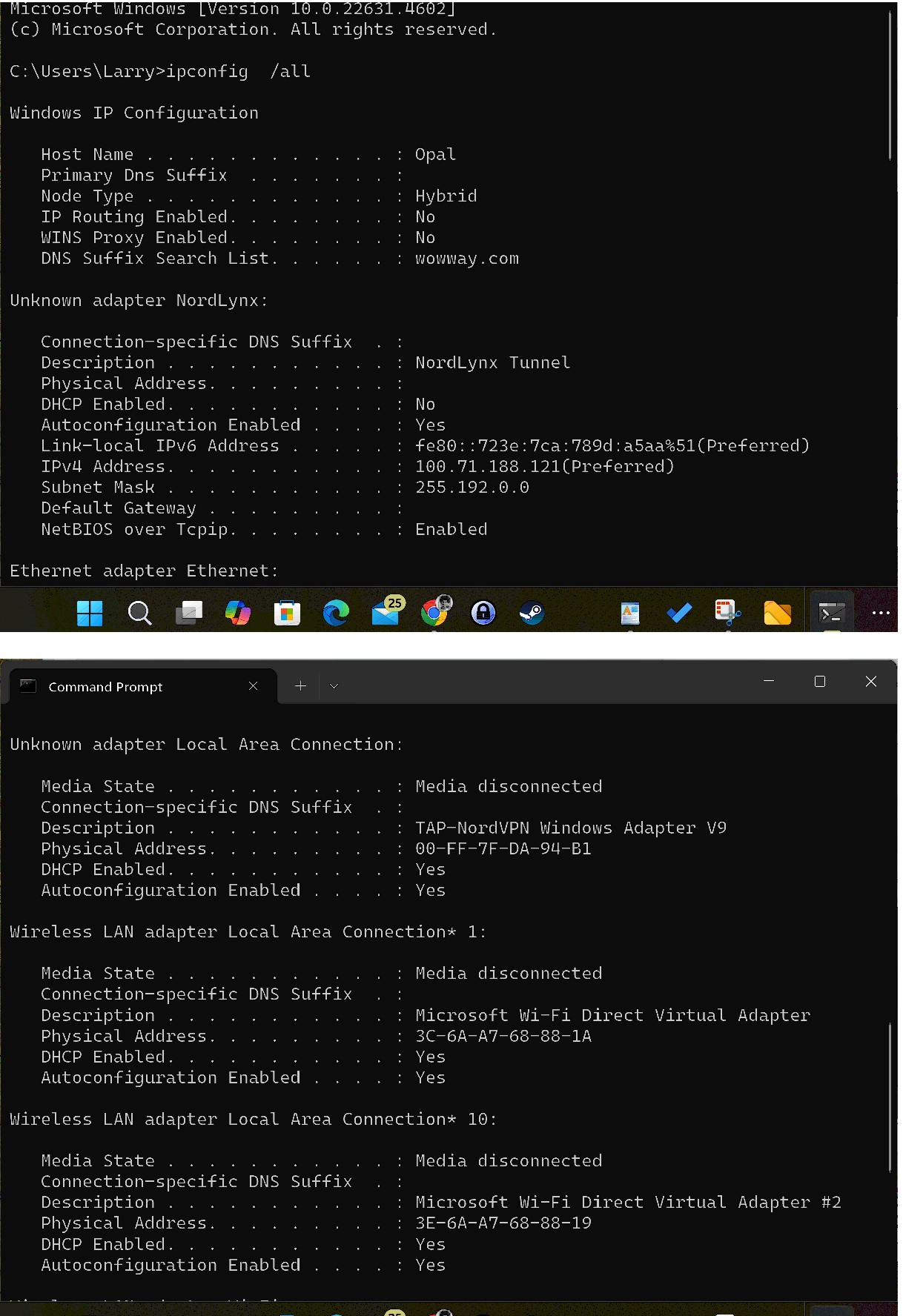

I'm attaching a copy of the ipconfig /all command output
On the same PC? That alone might be causing an issue, if you are on ethernet from a PC then turn off the Wifi.
You are connected a VPN, disconnect from the VPN to access local LAN traffic.

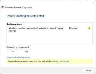

I've disabled WiFi on my computer, disabled the VPN and I get the same results.
Tried hard reboots soft reboots ( http://192.168.0.50:8081/ ) also with same results. I can't run the diagnostic tools.

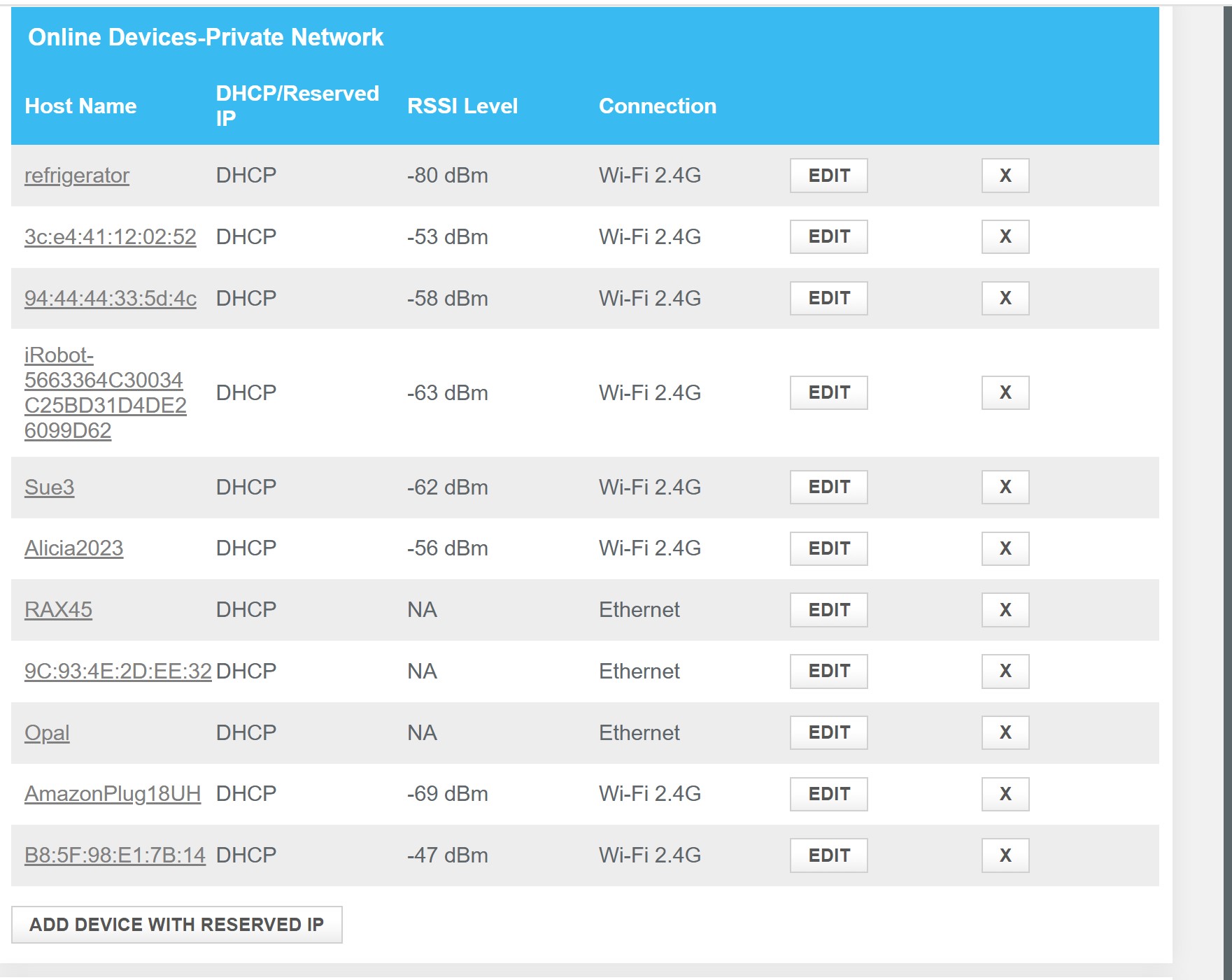

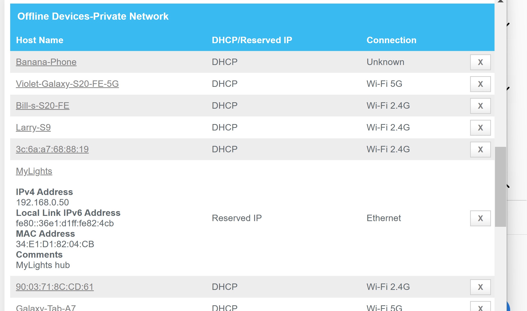

Have you ever checked your routers devices list to see if it shows up there? Possibly with a different IP.

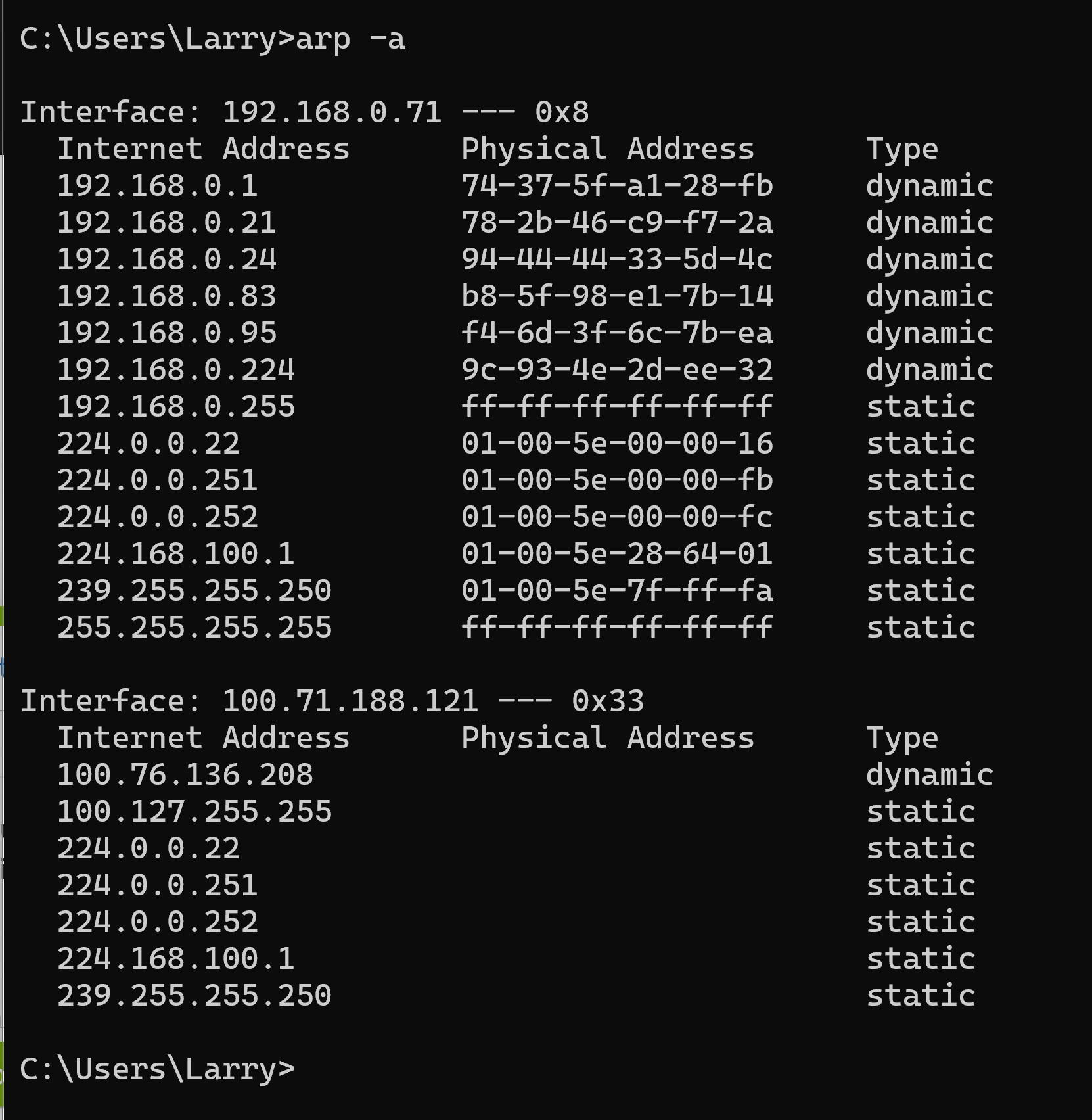

You can also run arp -a from a command line and look for the hub MAC is n the results.

What is the MAC address on the bottom of the hub? That should match the 34:xx number.
The WiFi MAC will be different, but still start with 34:xx
