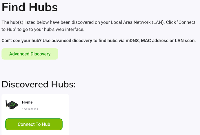

The light on my C8 hub is green and automations are working, but when I try to connect I get " This site can’t be reached". Tried another browesr, too. Using hub discovery I see it there. I restarted the hub by pulling power, no change. What am I missing here?

Can you reach the hub via browser at 172.16.0.144? Are you on the same subnet?
I can't browse to it by IP address, and I'm on the same subnet. One thing I didn't do was restart my network hardware.... I'm going to do that now.
check if you can ping it. If you can see if you can go to 172.16.0.144:8081 to get to the service menu. If so do a restore from last backup.
Did that & it worked! Luckily I had backed up recently.
Thank you!
