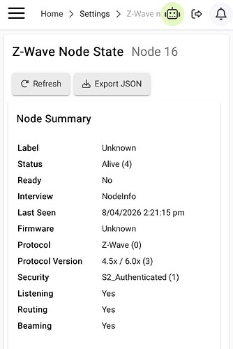

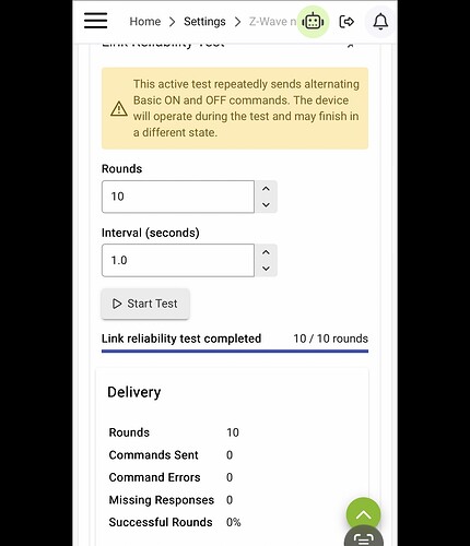

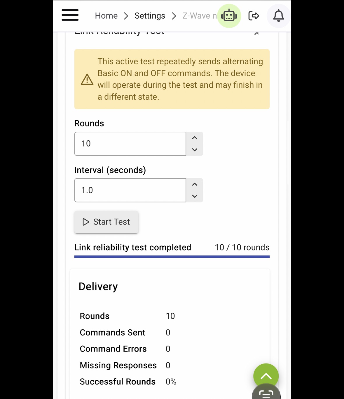

I’m getting a weird combination of responsiveness using the link reliability test in the zwaveJS settings, and some other places look like it’s communicating just fine. Yet it will not receive any commands and it will not make any sound. It does not do anything.

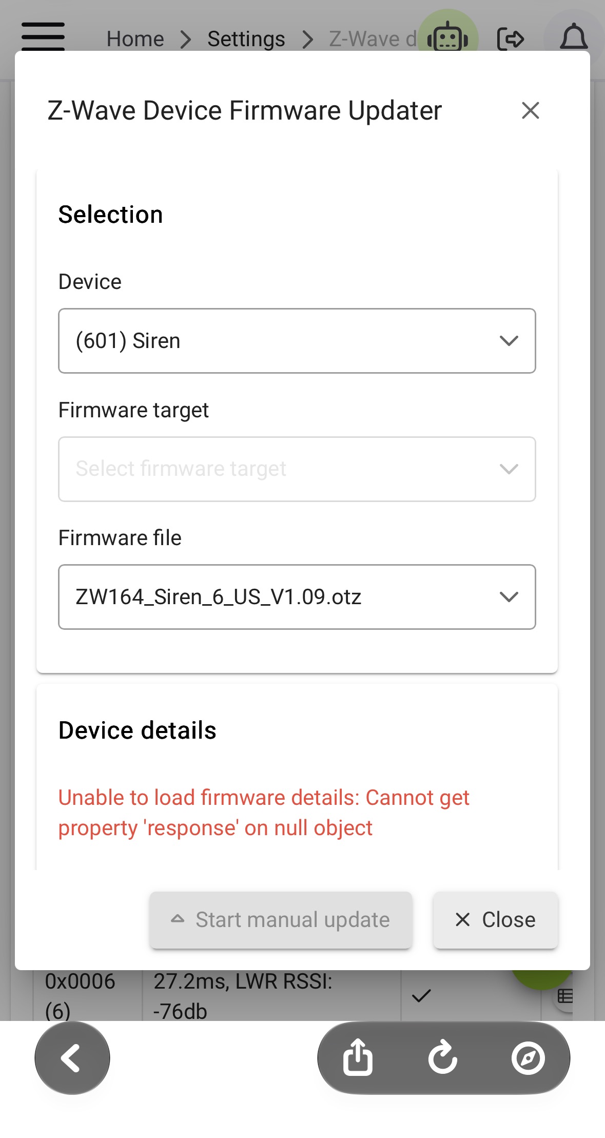

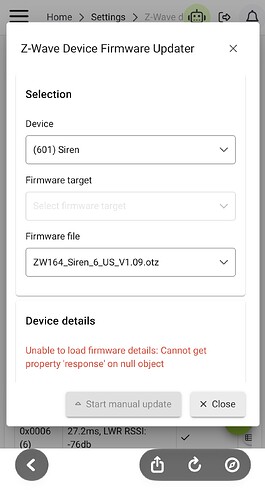

I cannot update the firmware using the built-in Z wave JS functionality because it cannot receive the current firmware information from the siren so I can’t even begin the update or check out for the automatic updates
I tried the Z wave firmware updater driver, but it immediately tells me to wake my sleepy device, which doesn’t make sense because it’s a main powered device not battery powered. I humored it and still pressed the action button on the siren a few times and it didn’t “wake up”.

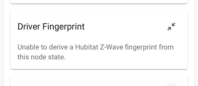

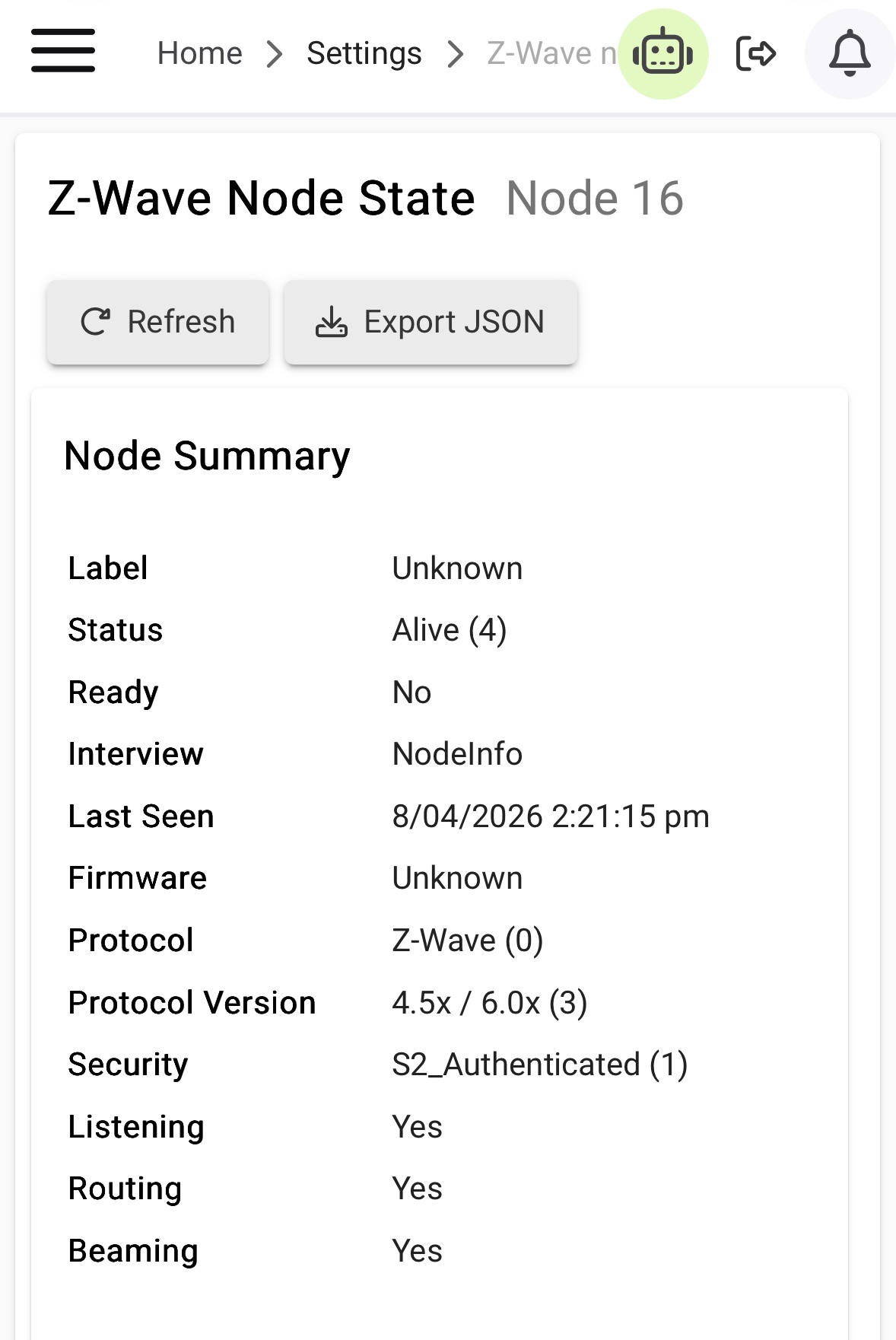

It looks like the node interview didn't complete or completed with errors..
There is a backdoor method to force an interview on a specific node..
/hub/zwave2/reinterview?node=16

Enter that into a browser with http://your-hub-ip-address/ before it.
For example: http://192.168.1.2/hub/zwave2/reinterview?node=16
:thinking: .. Have you tried since the ZWave-JS update?
Ah that makes more sense to me, thank you both. Entered it, received a confirmation "done", but the Siren is still behaving as before.
So am I correct in my thinking that I can either Factory Reset or try to repair the firmware with a z-stick device at this point? Nothing else really?
