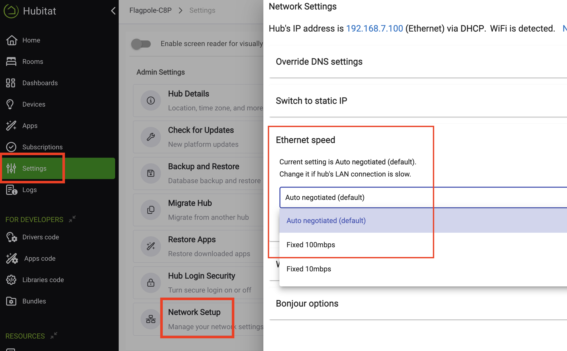

Try flipping this setting to whichever one it's not currently (Auto -> Fixed 100, or vice versa).
Switched from fixed 100 to "auto".
10 seconds to download.
Thanks, that did the job.
And introduced me to a bunch of network stuff I can mess up.
Chances are, you did this once before in the past.
Auto-negotiate is the default (as demonstrated by your screenshot).
I’m not sure if anyone knows why flipping it back and forth (in either direction) solves this rare firmware update quirk, but it’s been well-described for a few years.
The theory I've heard is that changing it forces a connection renegotiation between the hub and the switch/router, which clears up whatever issue(s) had mucked up the connection. :man_shrugging: Could also be that it calls a leprechaun network engineer who fixes it with magic from the ethernet. :wink:
