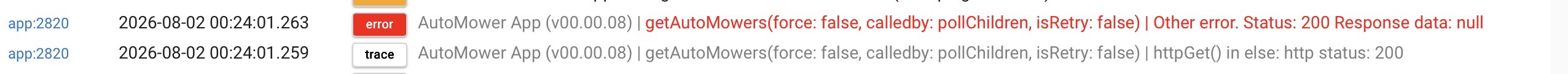

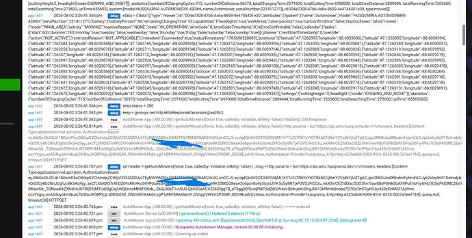

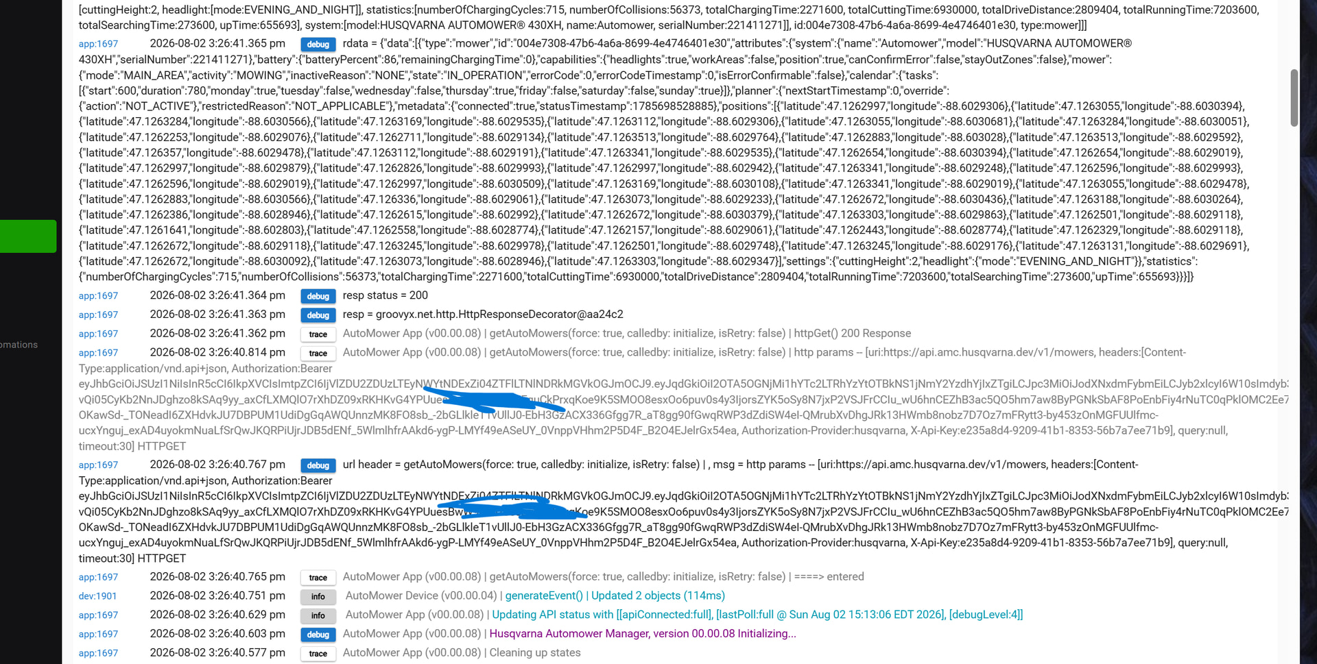

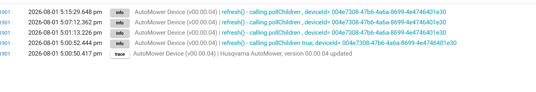

here is the working log image

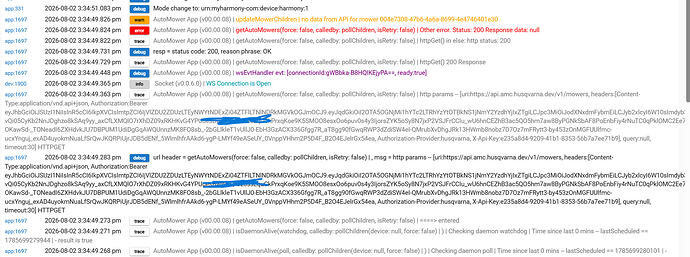

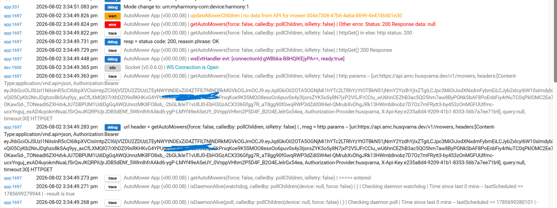

and the same call not working after upgrading again (part of the token commented out for security reasons)
working on older firmware
more info please look into it but the httpget is broken.. when using json or text
