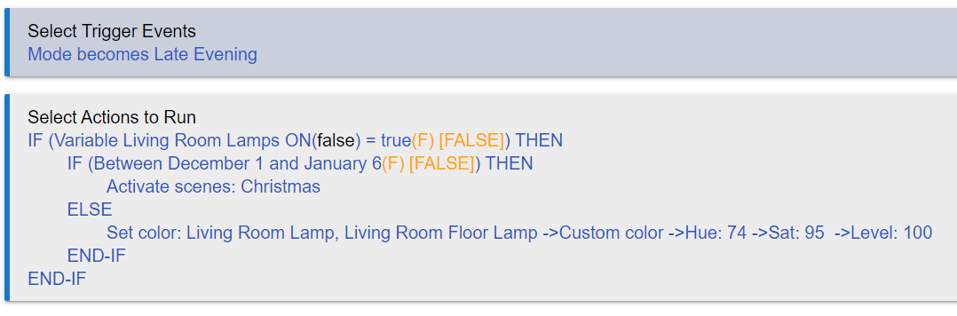

Yes, I have a Hubitat rule that runs @ 11pm and changes that bulb to that hue/saturation value if the bulb is on (last night it was). I checked, and the rule that changed the color of that bulb to purple was not triggered at any other time... :thinking:
Please post a screenshot of that rule so we can review it.

Of which rule? The one that turns the bulb purple at night?
I don't think that one is to blame, as that rule controls more bulbs than just the one in question. Technically, if this rule had run this morning then another lamp in my living room should also have been purple...but it was not.
Anyway, here it is:

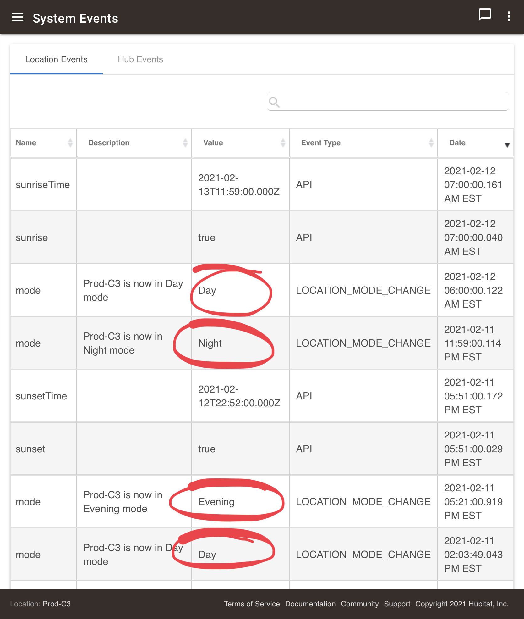

Just to completely rule out any possibility of the rule you shared above having been fired, can you please take a look at your hub’s System Events and make sure the Mode did not somehow change this morning?
It’ll look something like the following...
