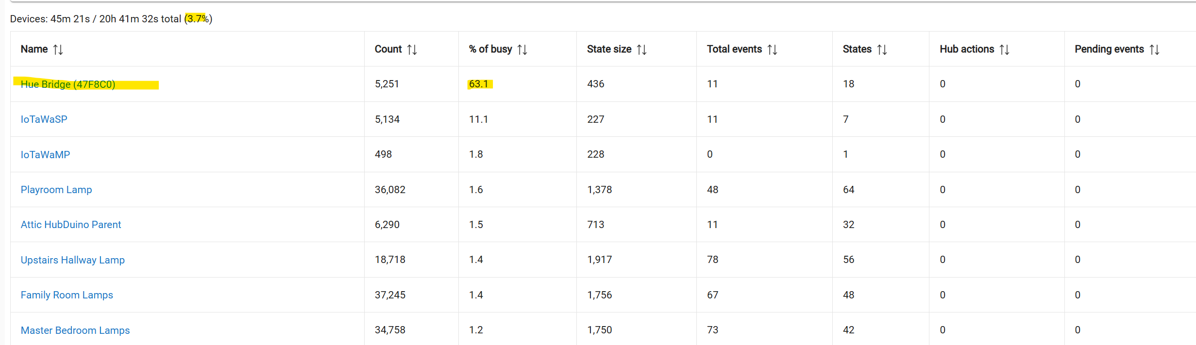

Things have been somewhat slow on my C8 with v2.4.3.177 the last several days. I looked at the cpu load within Hub Information driver and it was hovering around 20%. The logs/device stats showed that the Hue integration was responsible for 62% of that cpu load. No idea if that has anything to do with the slow responses but I disconnected the Hue hub and my cpu load dropped to 4-8%. So my question is....

Looks like a Hue reboot helped a lot for now. from 20% down to 2%. I have had this before though and over time the hue starts eating more and more cpu. I really like to have it off my main hub but not sure the alternative will be any improvement

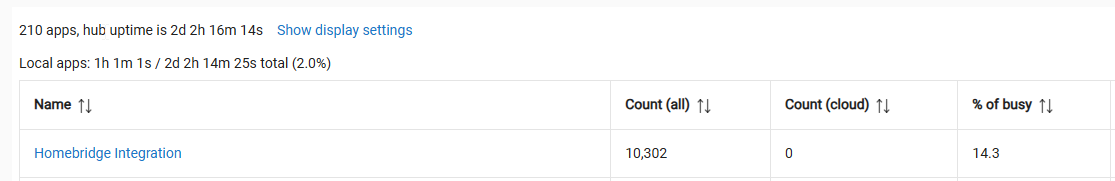

You have to look at the stats on the top of the App/Device Stats page to understand what the busy % of each app is telling you.
This shows my hub was up for 2d 2hrs. Of that uptime CPU busy time with apps is 2%
Out of that 2% (1h 1m), the Homebridge Integration accounted for 14.3%, so 8.7 minutes of CPU time, out of 2 days of uptime, so basically nothing.
I don't know why they display it like this, it is very confusing for most people to understand.

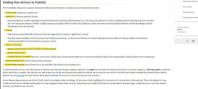

Actually, things have changed pretty dramatically over the last year with respect to Hubitat's built-in Hue Bridge integration. @bertabcd1234 expanded its capabilities dramatically, utilizing Hue's new API.
Huh. Never seen this. Is this another version of the app?
NVM: Just installed the integration on my "test" hub. I don't know how I missed this. Oh well, leaving for vacation in 3 days. Probably not a good time to implement something new. Thnaks for the info, though.
A year or so (maybe 2?) ago, the native Hue integration was refreshed and now looks much like CoCoHue. Not surprising, as bertabcd1234 created (and still manages) both integrations.
