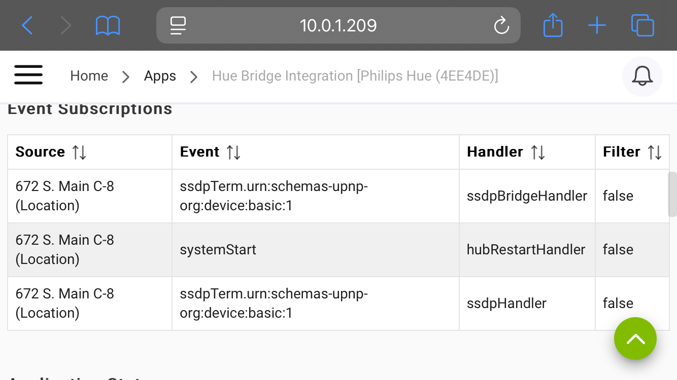

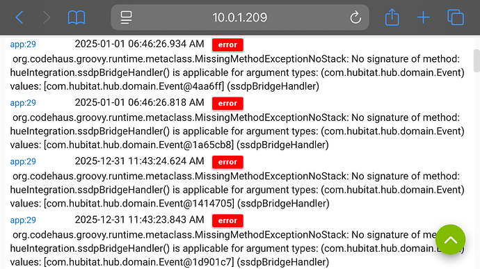

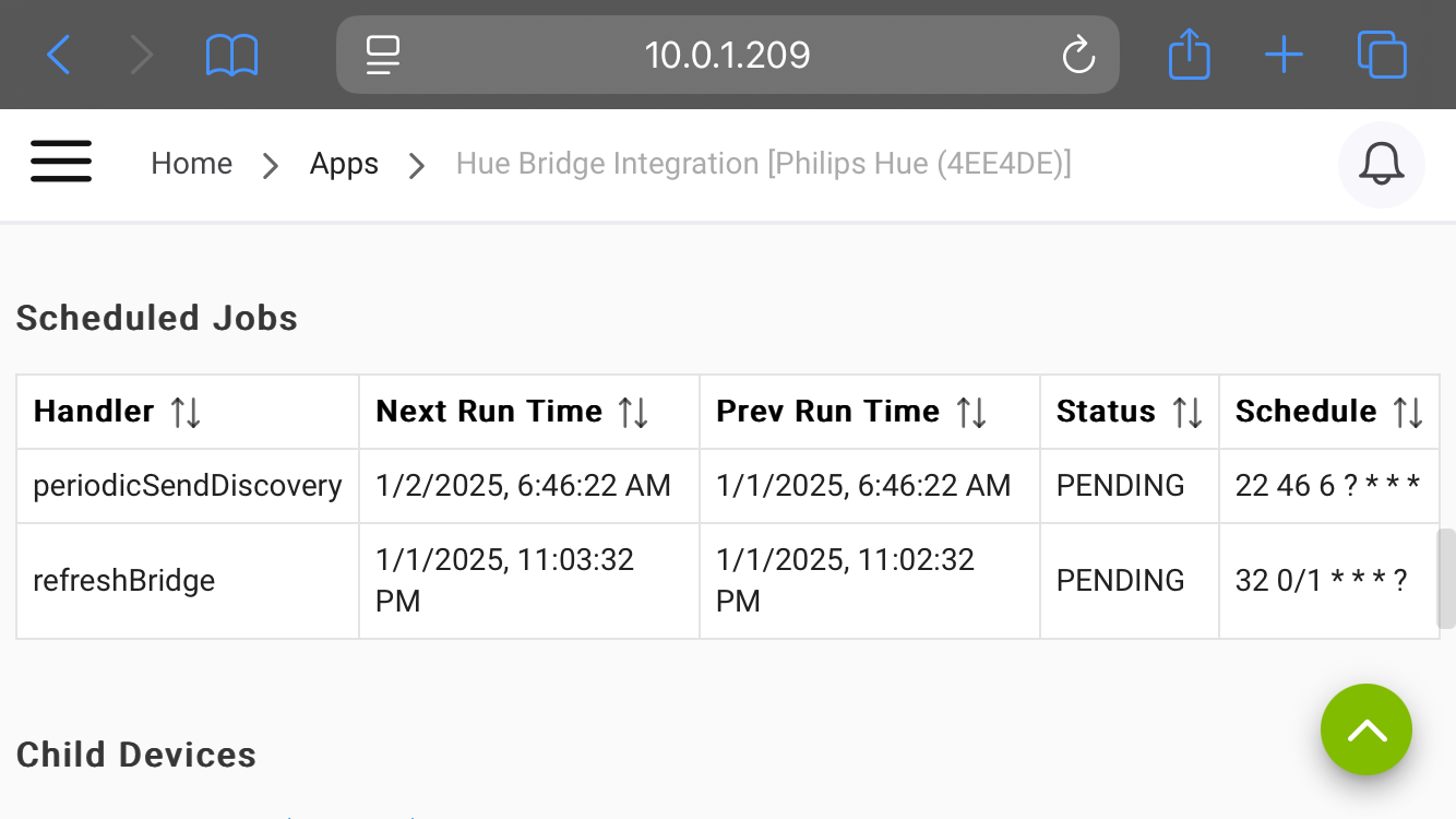

Not quite the same errors as above, but infrequent pair of errors with built-in Hue Integration on Hue Color Lightstrips (3 lightstrips) using hueBridgeBulbRGBW driver on C-8 with 2.4.0.145. Not using V2 API.
Errors:
The first pair of errors occurred immediately after systemStart following update to 2.4.0.145, when my systemStart triggered rule initialized the lightstrips. The second pair occurred this morning when we got up.
Not often enough to cause issues, and everything appears to be working.
That method is no longer present or scheduled as handler in the current integration, so it looks like something got stuck (perhaps because of your previous errors). A "Done" in the integration app should fix that, or if not, the usual tricks to delete this specific scheduled job should work, which I can help with if you're not sure -- but I'd still be curious if the above didn't do it for some reason.

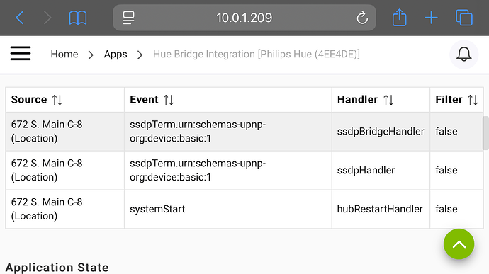

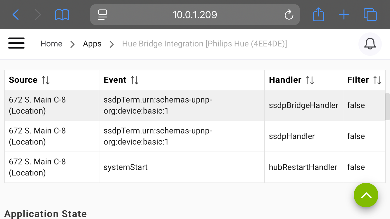

Ok. I went to the Hue Integration app and saved a screenshot of subscriptions:
I then went and hit Done. Subscriptions look the same now, but times changed slightly for scheduled jobs. Will see if the occasional errors repeat in the future. Thanks.
D'oh, this one is a subscription, not a scheduled job. This is probably because it didn't clean that up from the older version of the built-in integration. You can probably trick it into doing so by going to the edit Bridge page like you're trying to change the IP address or SSDP/discovery preference (but don't), but I will add something to prevent this for new upgrades in the future.

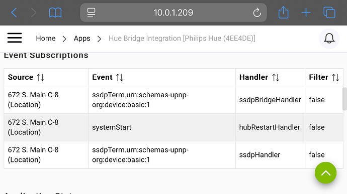

I don’t believe that cleans things up. Went to the edit bridge page, refreshed bridges, selected the same (only) bridge, clicked next, looked at subscriptions, etc., unchanged.
A closer look at the code makes it look like you'd need to turn off discovery (SSDP) for this to work (you can re-enable it right after if you had it on before). But a "Done" will fix this in the next build if you just wanted to wait. It is a harmless error in the meantime--the Bridge must be sending an SSDP advertisement on your network, and the old handler for that is still around, even though it's handled differently (and still would be despite this) with the updated version.
I assume that “turn off discovery” means to turn off “remain subscribed to Bridge discovery requests”. Turned that off, clicked Done, went back, turned it on, all that changed was that the subscriptions became re-ordered, but nothing else changed.
My Hue hub has DHCP reserved IP, so, in a sense (as I understand this setting), it doesn’t matter for me.
Anyway, this doesn’t seem to remove the subscription. Regardless, it doesn’t matter, error is harmless.

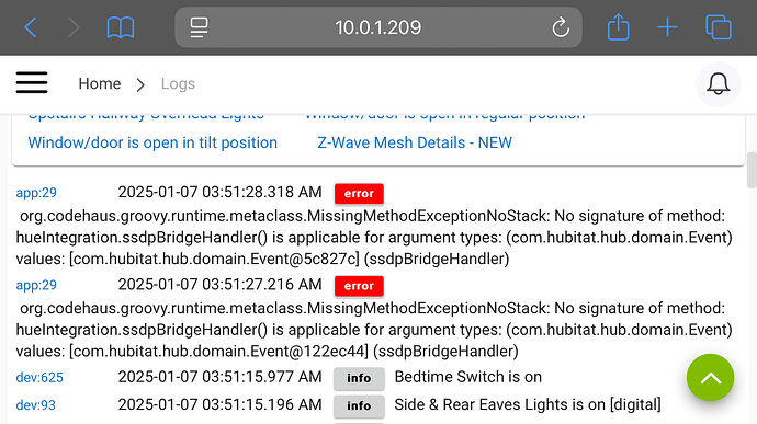

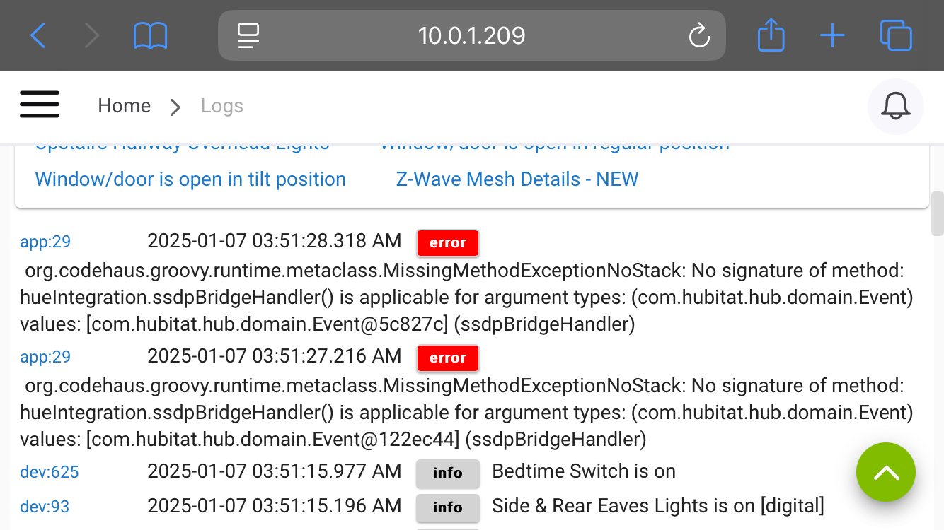

Robert, simply an FYI, the same issue still seems to exist in 2.4.0.146, update applies moments ago, the pair of errors occurred on the systemStart reboot after update. No big deal, it seems harmless.
I'm seeing these 2 errors as well. The last 3 days they have come in at 6:33am. Very consistent, 2 of the 3 at 6:33:10 and 1 at 6:33:09. Everything seems to be humming along nicely though. Reading through this I just turned off Remain subscribed. I did not see that setting when I set it up.
