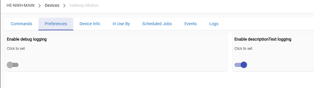

Tried toggeling debug slider, removed the motion sensor and re-imported it, nothing seems to fix this issue.

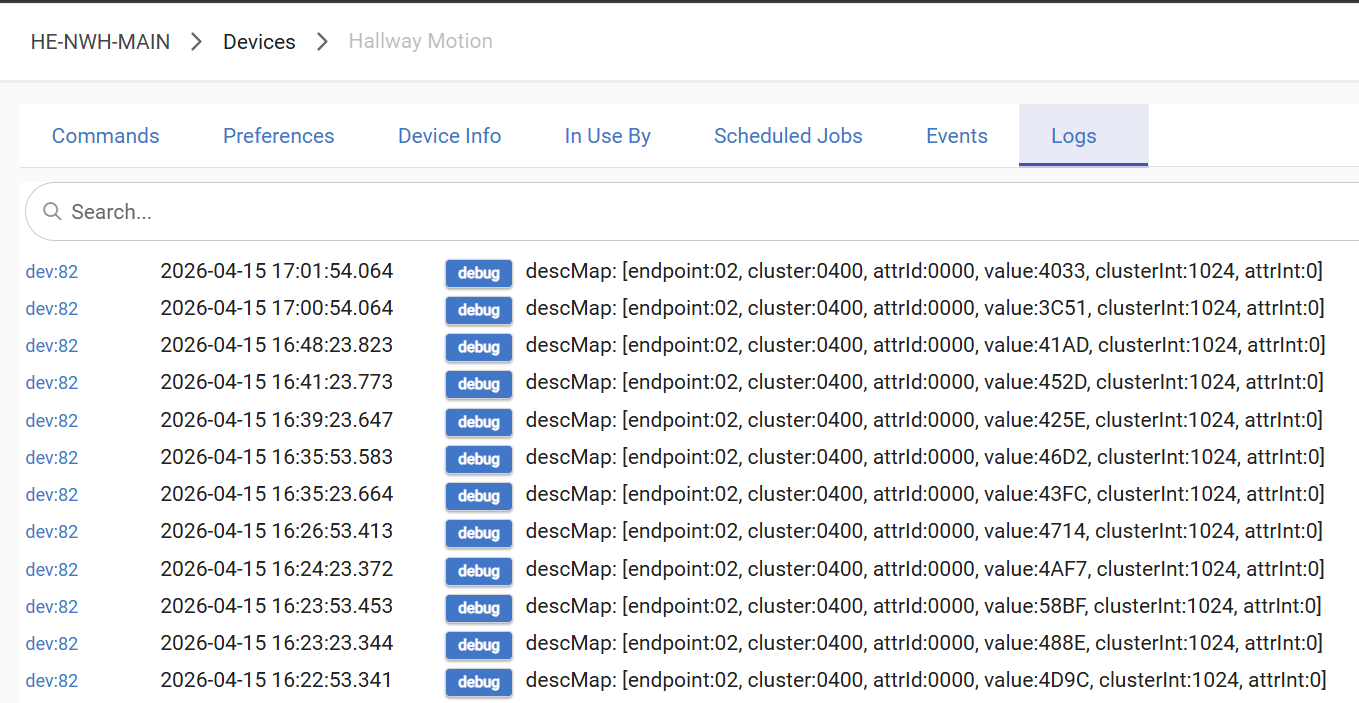

The log in your screenshot shows that at least this one is -- that log entry contains Zigbee or maybe Matter data but is not from the Hue Bridge Integration.

Edit: Actually, when the setting is false, the preference switch should also show off, so if it is still showing off while sending debugs, you may have a different issue.

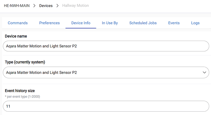

We really need to know which Driver that Motion Sensor device (dev 38 in the logs) is using, as @bertabcd1234 has asked above a few times. If you're somehow using a community developed driver, that might explain why the debug logging isn't fully turned off. Even if using a built-in driver, the only way the Hubitat team can take a look at the issue is to know which driver's code to review.
Sorry for my late reply, kind of swamped with work. I see i placed the wrong screenshots to my original message. It's from another device that is doing the same thing as the Hue device.
After removing the Hue device again and including it on the hub again, that one is not sending any debug messages anymore.
Still have one device, an Aqara Matter Motion and Light Sensor P2, doing the same:

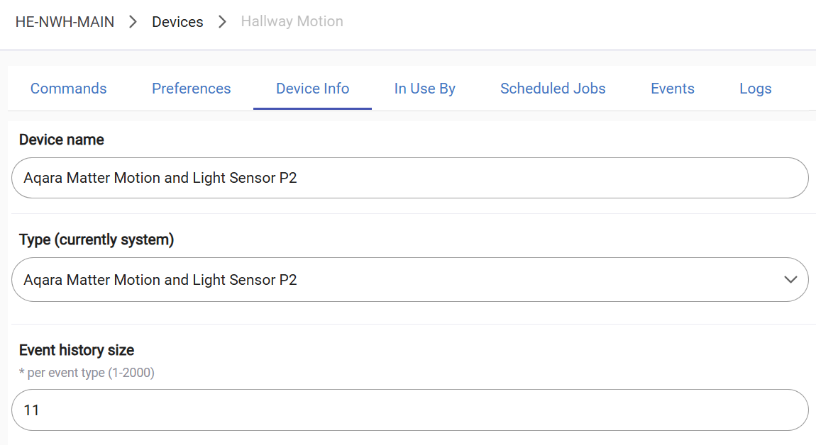

It was included from my homekit using matter, and is using the default Aqara driver:
That makes more sense! :slight_smile:
There was a typo in this driver that would make the "descMap" debug logs appear even when disabled, which will be fixed in the next platform release, currently in beta.
In the meantime (or really forever), if you want to work around this, I'm pretty sure you could use the "Generic Matter Motion/Light Sensor" driver (be sure to run "Configure" after you switch). I never tested this exact device with the driver, but the Aqara driver pre-dates the "Generic..." one, and the generic should be generic enough to work with any device that matches these capabilities.
