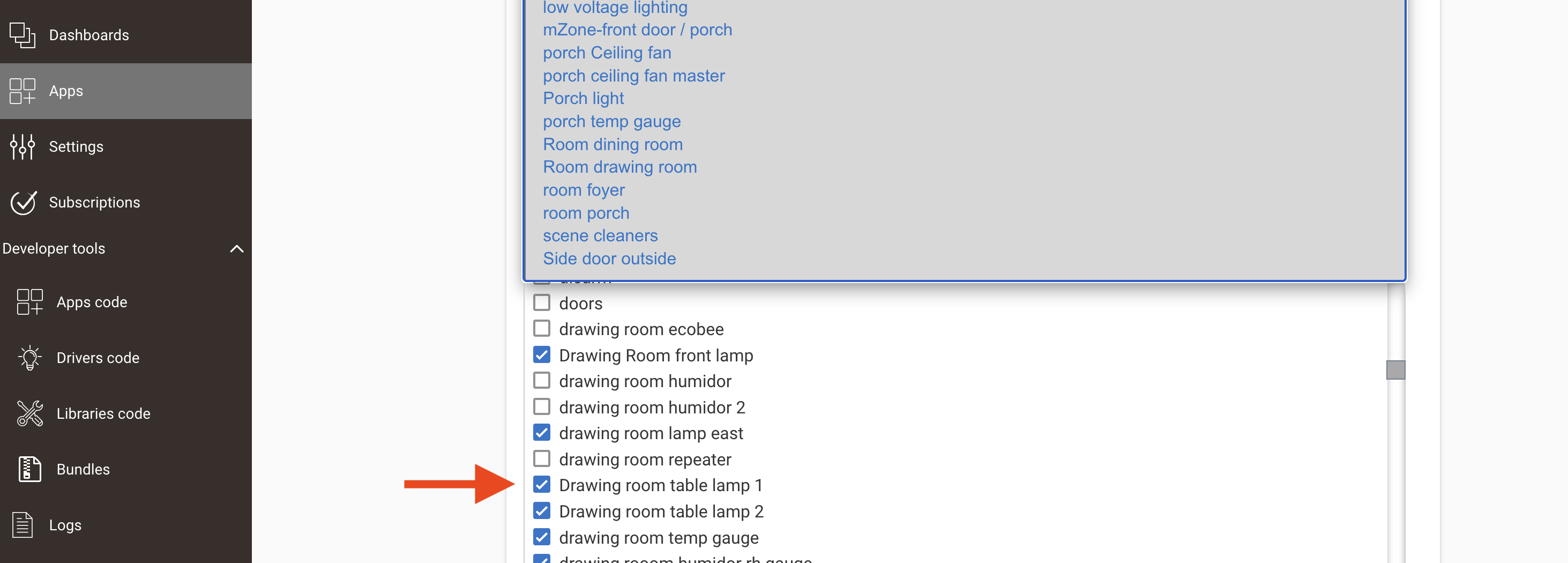

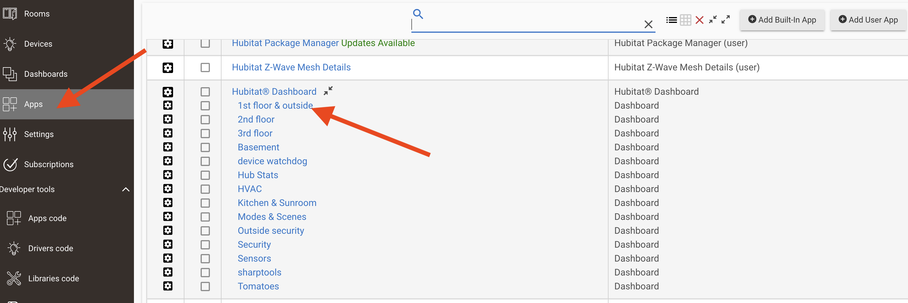

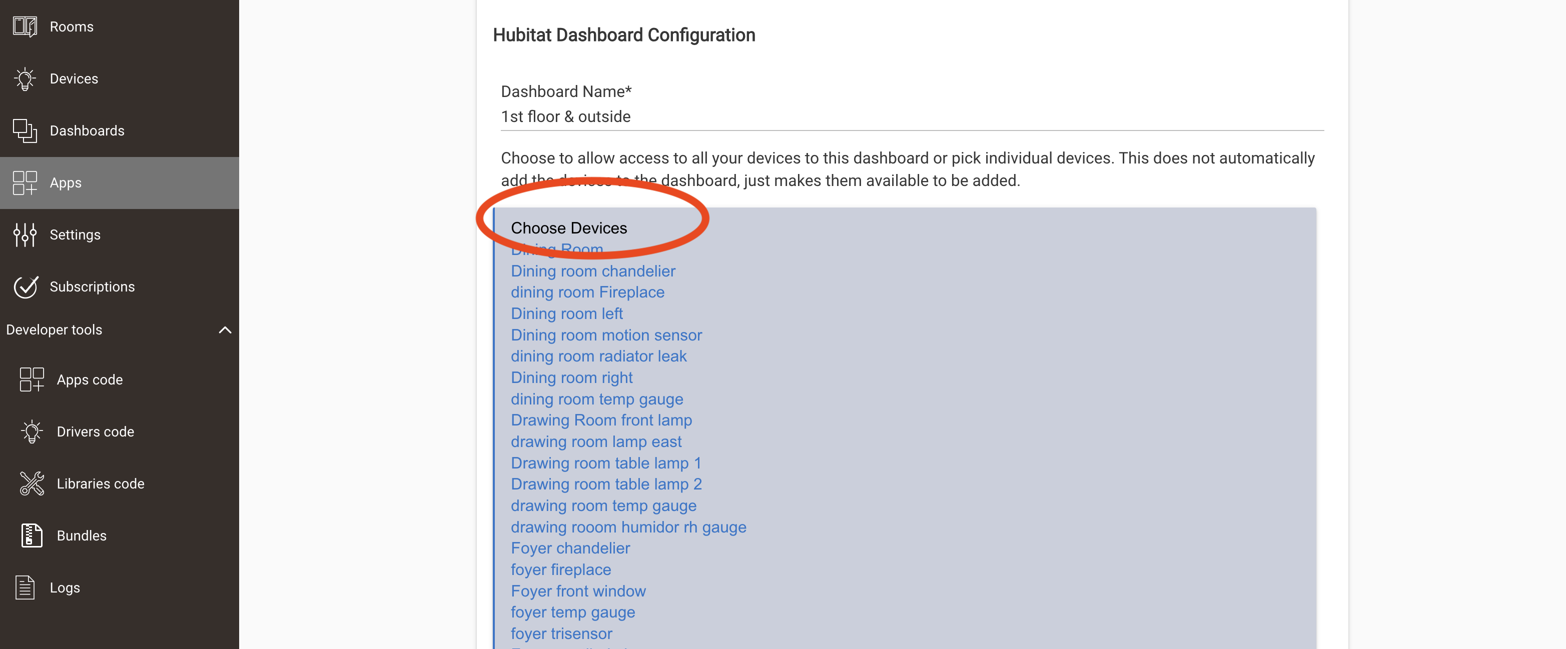

Just to be extra clear, does this "config page" look exactly like the screenshots above? That is where you need to be, but there are two places that let you "select devices" in Dashboard--the above, accesible under Apps on the hub, and the Dashboard itself when you're adding or modifying tiles. The latter won't show these devices unless they were authorized by the former.
If that is where you're looking and they still aren't there, maybe try a reboot. Make sure to do this from Settings > Reboot Hub whenever you can, not just pulling power. This may help if it's a cache issue or something. A soft reset and restore, as above, may also help if you have database corruption, and it's not too difficult, but this is even easier. :slight_smile:
