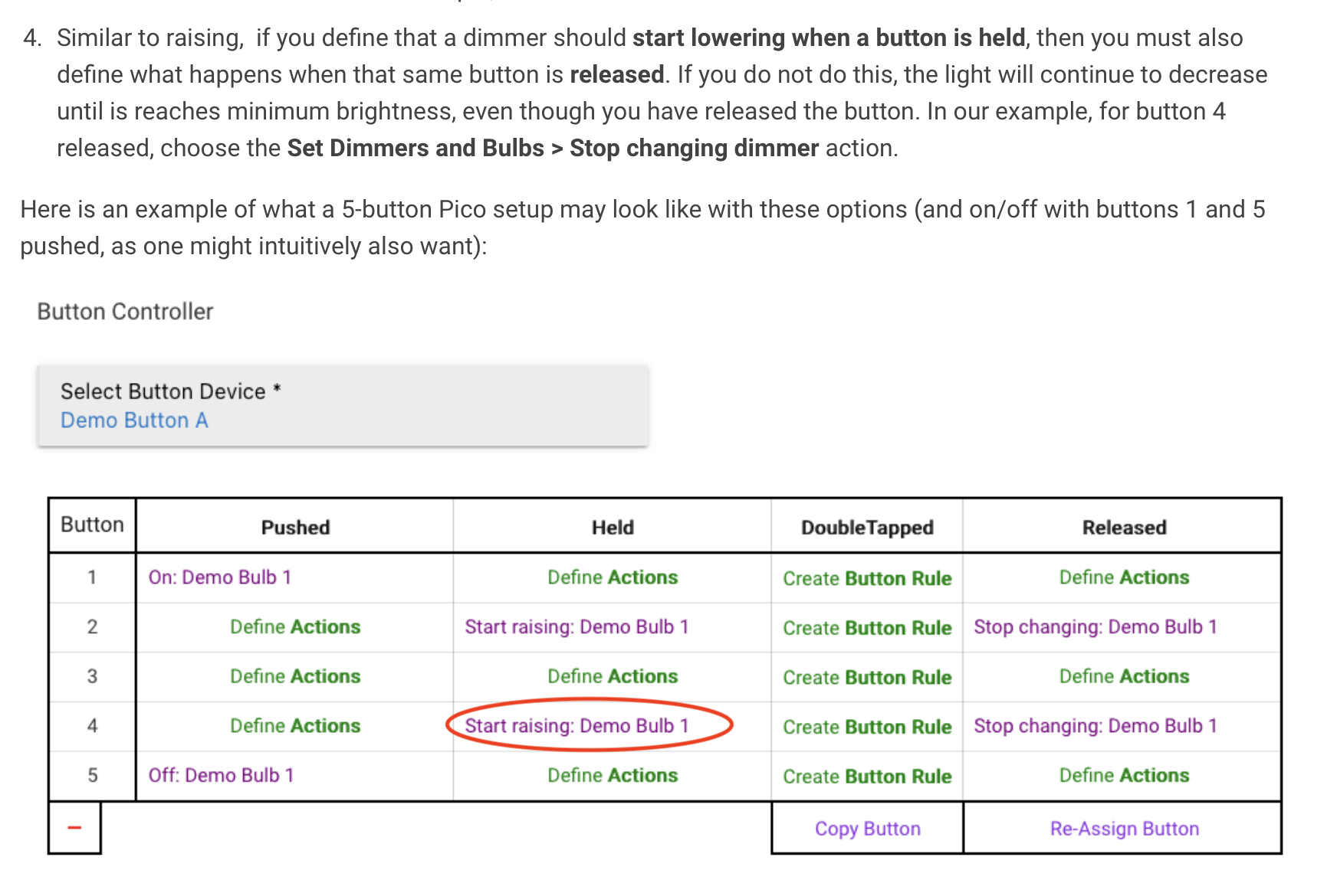

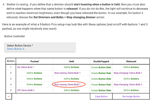

FYI unimportant but I noticed a tiny flaw in your docs. You describe a setup for a 5 button pico but it looks like in your example button rule that you'd copied the raise level commands to the lower level button so the screenshot doesn't quite reflect the description - button 4 should be 'start lowering' (very minor):
Thanks for catching that! Updated the screenshot.
