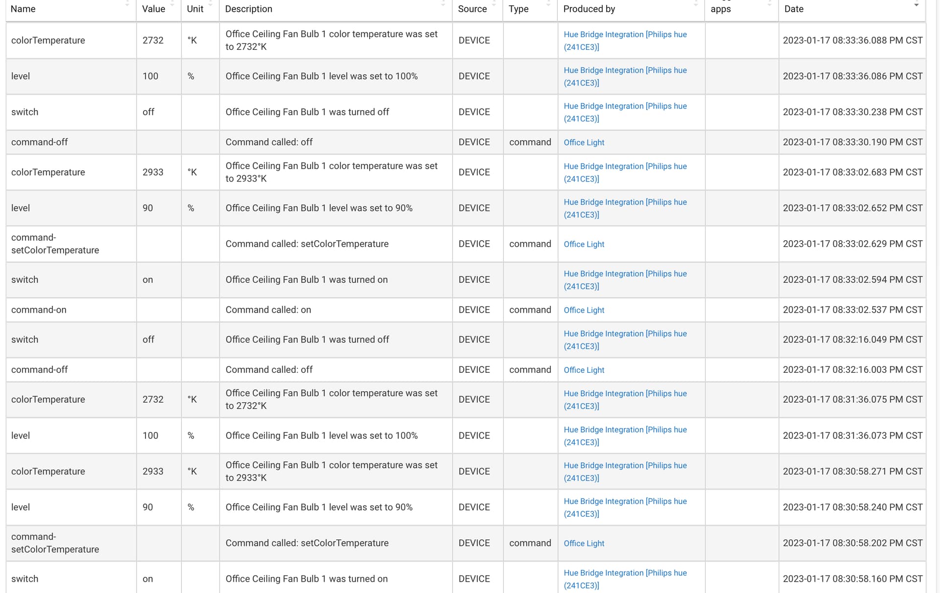

dev:3482023-01-17 08:33:36.089 PMinfoOffice Ceiling Fan Bulb 1 color temperature was set to 2732°K
dev:3482023-01-17 08:33:36.086 PMinfoOffice Ceiling Fan Bulb 1 level was set to 100%
dev:3482023-01-17 08:33:30.239 PMinfoOffice Ceiling Fan Bulb 1 was turned off
dev:3482023-01-17 08:33:02.683 PMinfoOffice Ceiling Fan Bulb 1 color temperature was set to 2933°K
dev:3482023-01-17 08:33:02.652 PMinfoOffice Ceiling Fan Bulb 1 level was set to 90%
dev:3482023-01-17 08:33:02.595 PMinfoOffice Ceiling Fan Bulb 1 was turned on
dev:3482023-01-17 08:32:16.051 PMinfoOffice Ceiling Fan Bulb 1 was turned off
dev:3482023-01-17 08:31:36.076 PMinfoOffice Ceiling Fan Bulb 1 color temperature was set to 2732°K
dev:3482023-01-17 08:31:36.074 PMinfoOffice Ceiling Fan Bulb 1 level was set to 100%
dev:3482023-01-17 08:30:58.272 PMinfoOffice Ceiling Fan Bulb 1 color temperature was set to 2933°K
dev:3482023-01-17 08:30:58.241 PMinfoOffice Ceiling Fan Bulb 1 level was set to 90%
dev:3482023-01-17 08:30:58.160 PMinfoOffice Ceiling Fan Bulb 1 was turned on
dev:3482023-01-17 08:30:36.079 PMinfoOffice Ceiling Fan Bulb 1 color temperature was set to 2732°K
dev:3482023-01-17 08:30:36.077 PMinfoOffice Ceiling Fan Bulb 1 level was set to 100%
dev:3482023-01-17 08:30:14.302 PMinfoOffice Ceiling Fan Bulb 1 was turned off
dev:3482023-01-17 08:28:00.312 PMinfoOffice Ceiling Fan Bulb 1 color temperature was set to 2933°K
dev:3482023-01-17 08:28:00.266 PMinfoOffice Ceiling Fan Bulb 1 level was set to 90%
dev:3482023-01-17 08:28:00.192 PMinfoOffice Ceiling Fan Bulb 1 was turned on
dev:3482023-01-17 08:27:36.789 PMinfoOffice Ceiling Fan Bulb 1 was turned off
dev:3482023-01-17 08:26:36.077 PMinfoOffice Ceiling Fan Bulb 1 color temperature was set to 2732°K
dev:3482023-01-17 08:26:36.075 PMinfoOffice Ceiling Fan Bulb 1 level was set to 100%
dev:3482023-01-17 08:26:23.674 PMinfoOffice Ceiling Fan Bulb 1 color temperature was set to 2933°K
dev:3482023-01-17 08:26:23.653 PMinfoOffice Ceiling Fan Bulb 1 level was set to 90%
dev:3482023-01-17 08:26:23.575 PMinfoOffice Ceiling Fan Bulb 1 was turned on
dev:3482023-01-17 08:26:06.632 PMinfoOffice Ceiling Fan Bulb 1 was turned off
dev:3482023-01-17 08:25:36.093 PMinfoOffice Ceiling Fan Bulb 1 color temperature was set to 2217°K
dev:3482023-01-17 08:25:36.090 PMinfoOffice Ceiling Fan Bulb 1 level was set to 35%

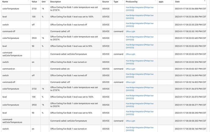

Check the event tab on one of the devices, if the commands are being called on the hub it will list where the calls came from (another app, etc...)
Thanks. I have not added Hue to HomeKit yet and the bulb has only been added to webCoRE.
On the Event Tab under Produced by, it shows Hue Bridge Integration [Philips hue (241CE3)] and Office Light.
Can you post a screenshot of it? Sounds like maybe it is coming from the Hue Bridge?
Is "Office Light" the name of an app or a group or something that you are using to control the bulbs? I assume webcore is commanding the "Office Light" group and then that is commanding the bulb.
The 2732 temp and 100 level do not appear to be triggered from Hubitat. Looks like something else is triggering it directly to Hue, and then hue is reporting the status back to Hubitat. Do you have any leftover automations setup in the Hue app that might be conflicting? Or could be anything else connected directly to Hue, like Alexa, Google, IFTTT, etc...

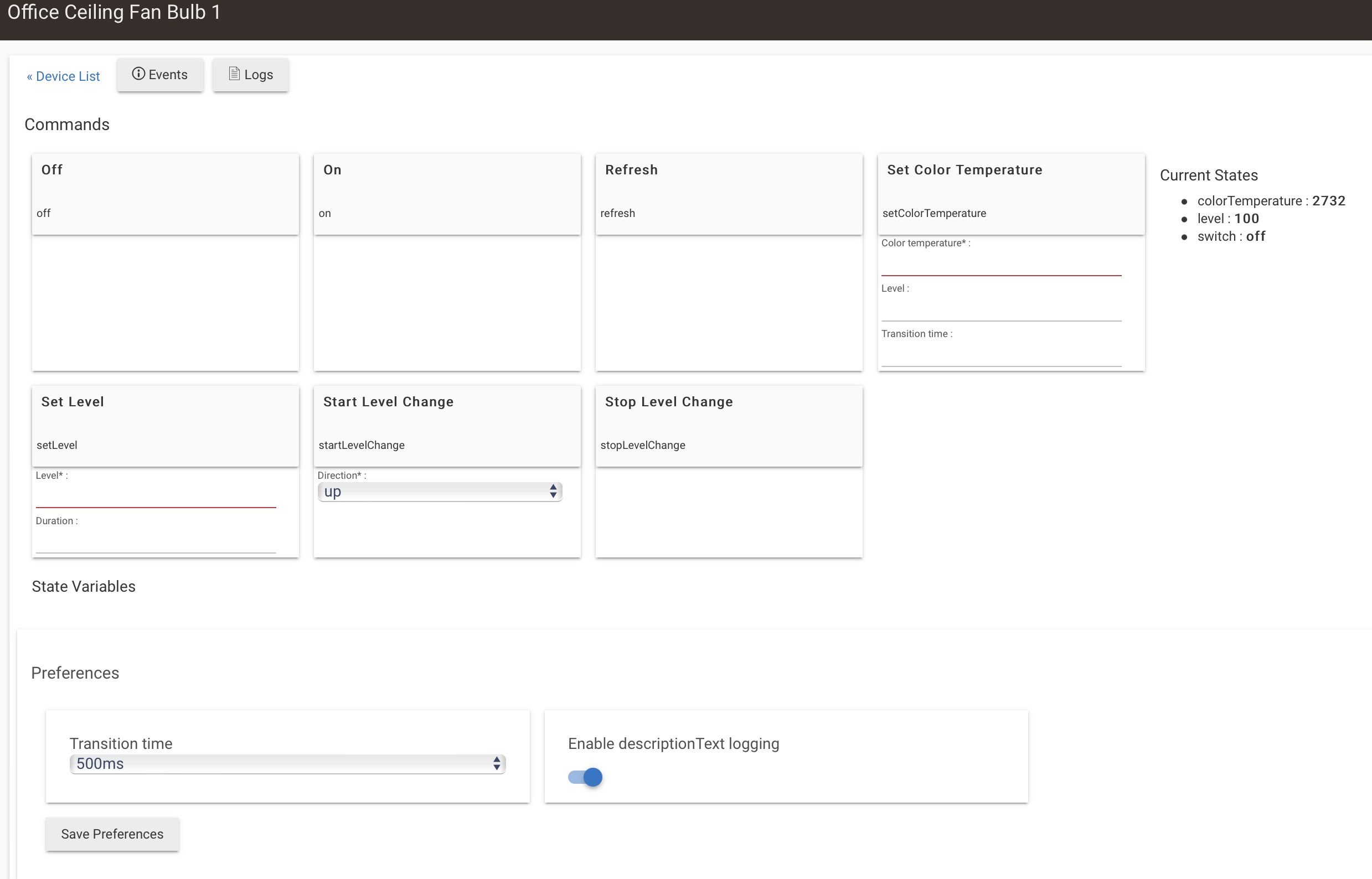

You can adjust the bulb settings under the device, the bulb is not on because the switch is off, but you can still adjust the bulb settings. See picture,

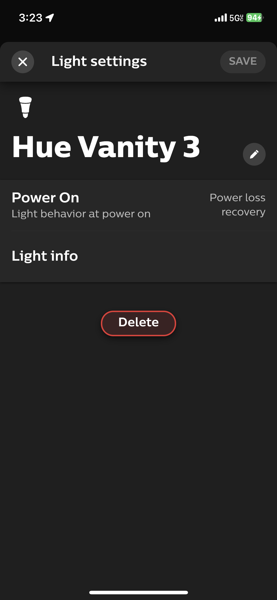

For what it's worth, the Power On setting for the bulb in the Hue app is set to Light Behavior at Power On. So I'm not sure why it was always going back to 2732K at 100%. But, I get that powering on and off the switch could cause weirdness.

That isn’t a setting. The setting default is a Hue scene like “bright” ~2900K 100%. I set mine to power loss recovery.
