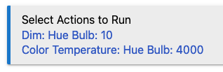

Is your rule action just setting the dimmer? That is, no other specific "on" action? Does the bulb do the same with "Set Level" directly on the device page?
My rule sets the color temperature and the level:
Color Temperature: Bedside Lamp: 50.
From the device page, if I set the level to 50, it works perfectly. From the device page, however, you can’t really set the color temperature and the level at the same time. You set one and then the other.
The built in Hue Bridge integration does not currently support the multi-parameter Set Level command, which will let you set level and specify rate in addition to just the CT. Long term, that will probably fix your problem (assuming Hubitat updates these drivers to match the new but little used capabilities updated in firmware 2.2.6...maybe in 2.2.8 since it didn't make 2.2.7?). Rule Machine would also need to be updated to use this command.
In the meantime, Rule Machine is undoubtedly sending two separate commands for this. I don't know in what order, but it sounds like maybe CT before level. If you do these as two separate actions yourself, you'll have control over which gets sent first. In your case, perhaps that is "Set Level" first. (I should also note that I wrote a custom Hue Bridge integration that does support this new command, but I'm guessing Hubitat's will get updated eventually, too, and I don't want to steer you there just for this reason.)
By “Set Level”, you mean the “Dim” command in Rule Maker, correct?
Yeah, the "Dim" action in Rule Machine should just send a "Set Level" to the specifier device.

I was able to replicate this behavior, and I confirmed that the app (Rule Machine) is indeed sending "Set Color Temperature" to the device before "Set Level." (Again, sending them in one single command is not possible with this specific device at the moment and has not historically been possible with any standard-command device on Hubitat, though that just changed and enough pieces should fall into place at some point in the future to make this smoother.)
In the meantime, keep in mind that the transition time is optional for the "Set Color Temperature" action in Rule Machine. Additionally, because of the above, two separate "Dim" and "Color Temperature" actions (I suggested this above) would have basically the same effect in the current implementation, and if you do it that way, you have control over which goes first. Since the level seems to bother you more than the CT, I would set the level first (though in the scope of just this example, with CT being 2700 in both cases, you won't even that here--though you may if it gets set to something else in the meantime...and really with Hue bulbs this is something I notice immediately after they come on regardless, if they were previously a different color/CT, so even being able to send these as a single command to Hue eventually might not even help you much more than this will):
