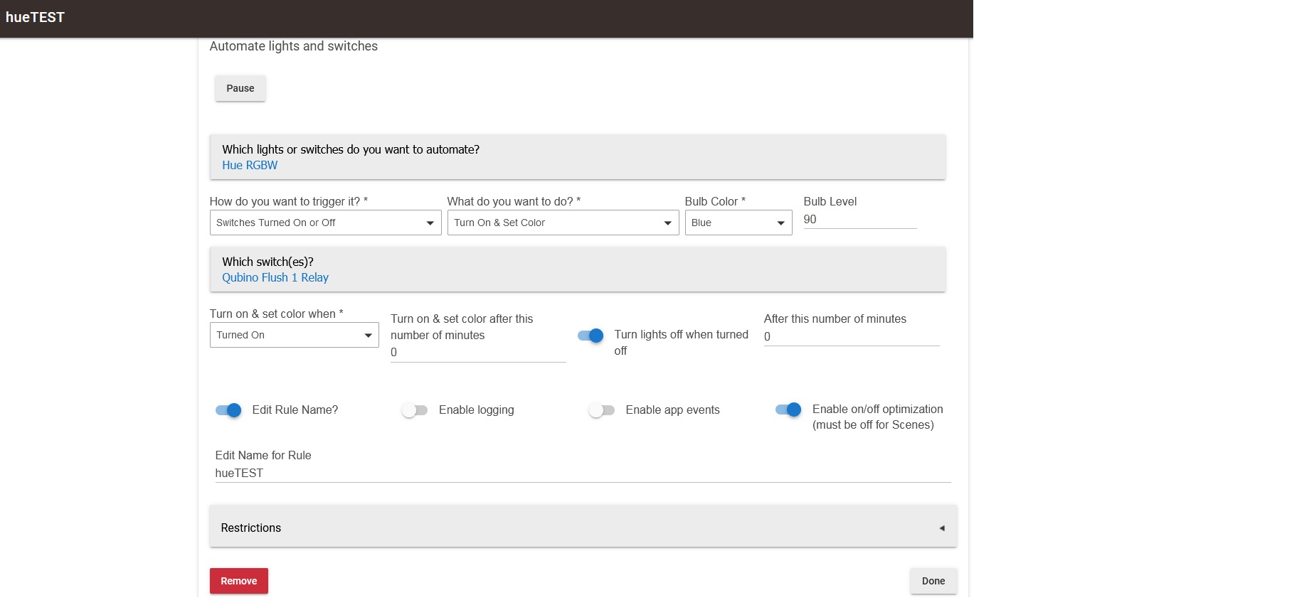

Hi, what a simple automatic rule should look like for turning on the light with a smart switch and setting the bulb color. The one below doesn't work. The light bulb is on but the color does not change.
I have Qubino Flush 1 relay as smart switch, and Philips Hue RGBW bulb (Hue Bridge Integration).
Thx
