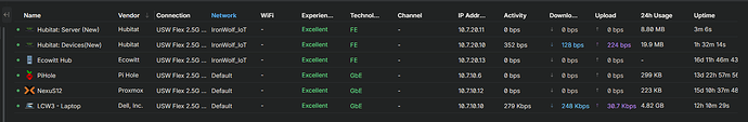

UPDATE: While writing this, I realized the issue may be network-related. The problem only occurs from my laptop on the default network—the hubs are on an IoT VLAN. However, this arrangement has worked fine for several months, so I'm not sure what could have changed. I am able to access both hubs from my phone and iPad when connected to the IoT VLAN.

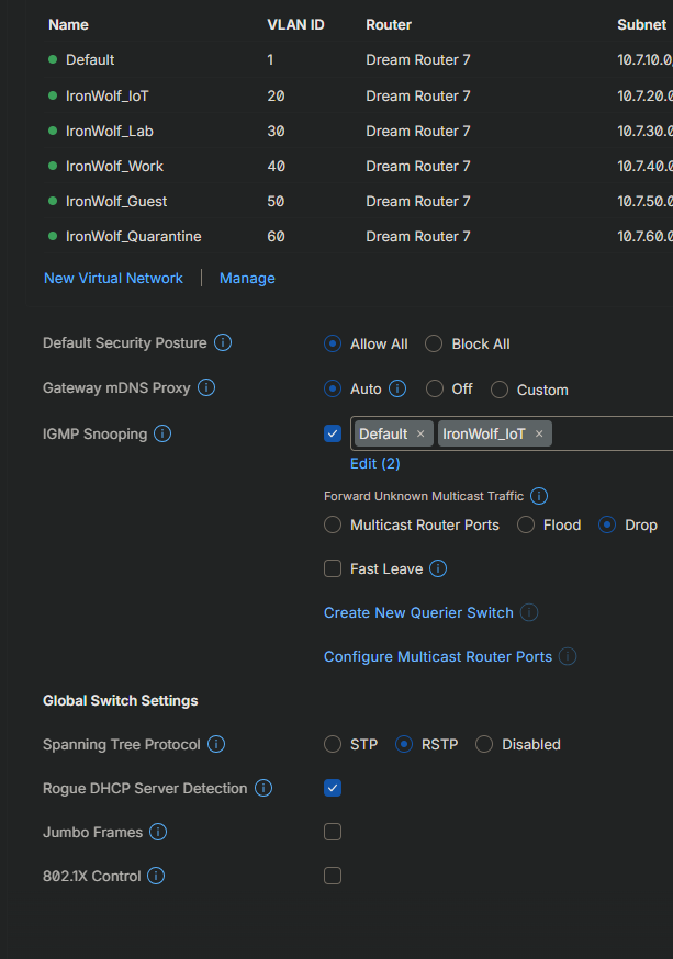

First, if you are on Network 9.5 or higher, there is a new setting called Default Security Posture, which now gives you the ability to Block All by default as opposed to Allow All. Check to see if that has possibly been changed from one to the other.
Do you have any rules that block access to the IoT network? Sounds like your default network is not allowed to reach anything on the IoT network.

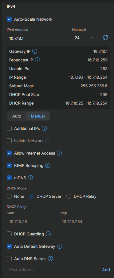

Have a look at this:

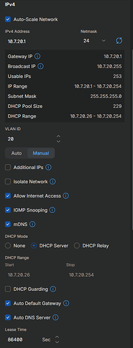

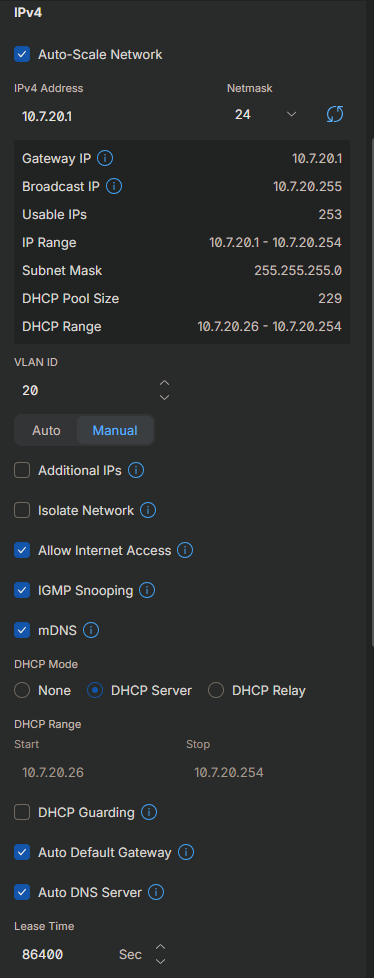

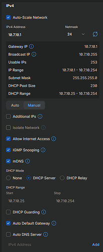

But I’m not sure I understand how your firewall is configured, if at all, since you didn’t include any screenshots.
Are your VLANs in different or same firewall zones? Did you create any rules yet?
