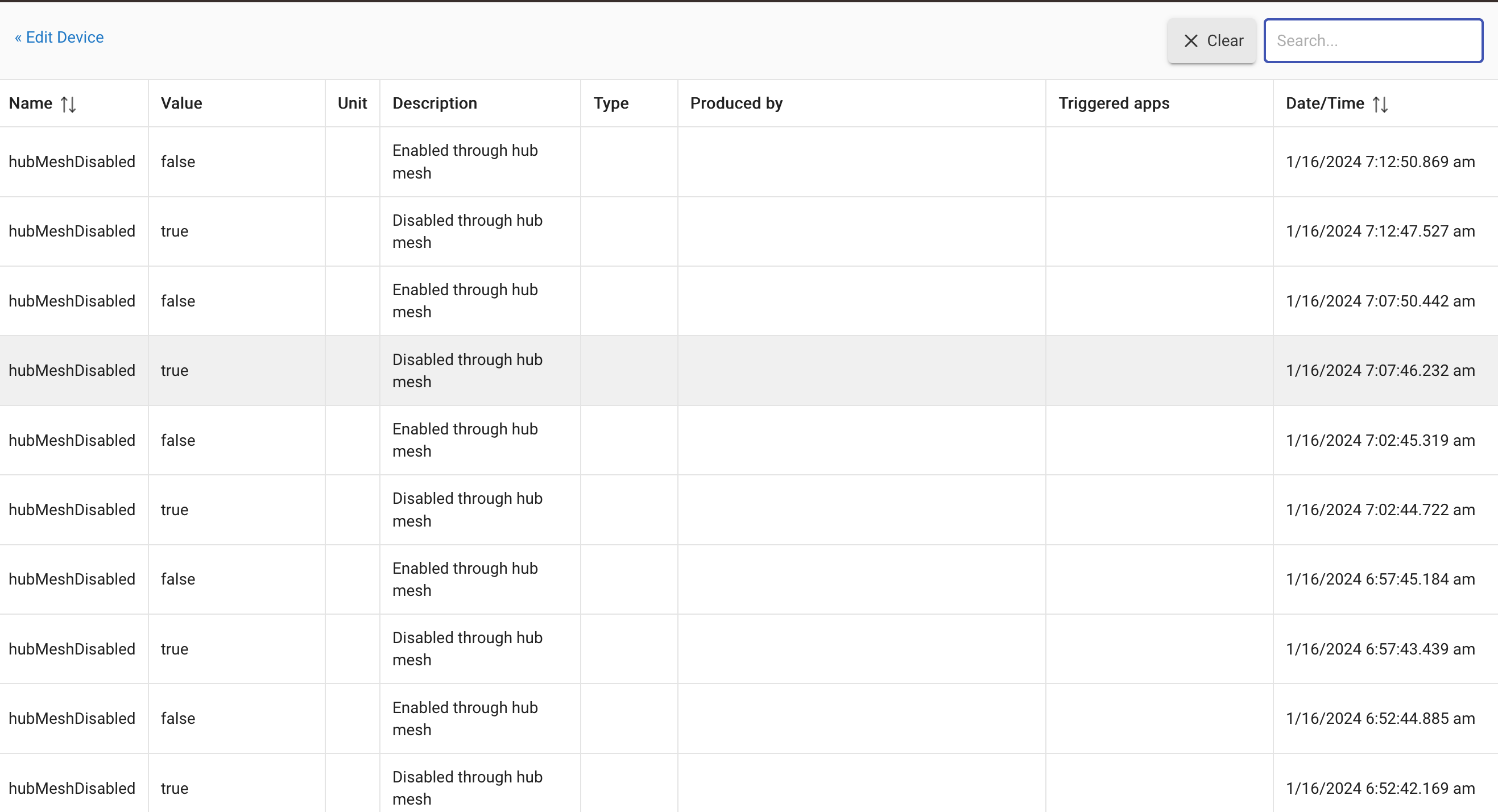

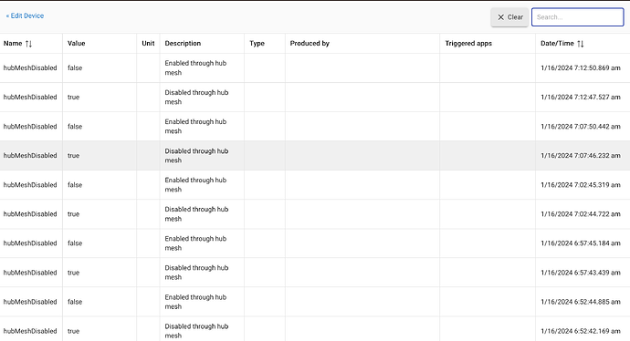

I have a few virtual drives on my C7 I'm sharing back with my C5, and they are full of these messages where I only see them on the mirror image (in this case in the C5 event logs) not in the main host (C7 in this case): "hubMeshDisabled" False/True togging back and forth.

So I did the router reboot to just check. No changes. Also reverted to 'hourly' sync and the hubMeshDisabled now is only doing that toggle hourly.
