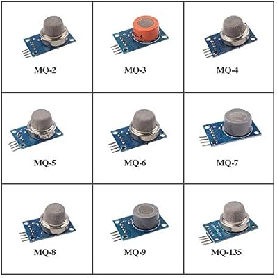

This is probably a good time to bring up that there are other solutions as well. It may not be small, precise and sexy as the Bosch solution. But, it is cheap. There is a variety of MQX sensors that would plug right into the Environment Sensor Analog input. Amazon has a lot of assortment of these. Here is an example.
I play around with one of them. It is a MQ9. I have a DTH for it as an example to use the Environment Sensor Analog input.
If there is enough interest to go this route, I can revive the topic and document it better. In term of cost, this is probably the most cost effective way to detect gas in your home.
Just a warning, the MQX solution is not sexy. There will be wire to connect. It also detect sensitive to smaller set of gas per MQX type. You would use MQ9 for Carbon Monoxide, Coal Gas, Liquefied Gas. You have to use MQ2 for Combustible Gas, Smoke. In comparison, I do not know how many type of GAS the Bosch sensor is sensitive to. In term of basic fundamental how it work, they should be similar. Bosch may just have perfect it.
