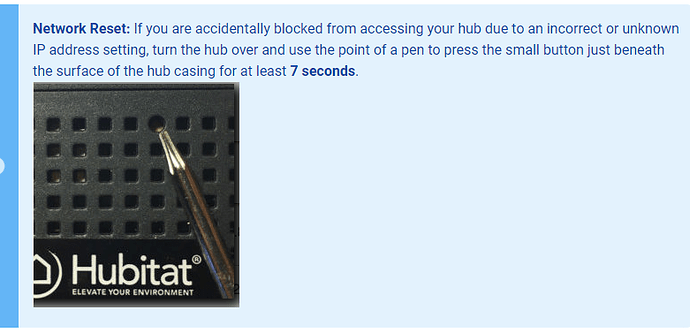

Did you have a static IP set on the Hub itself? You may need to do a network reset (This only resets it to DHCP, nothing else is changed): Network Setup | Hubitat Documentation
I don't know if I set a static IP on the Hub. I set a static IP in my router though.
I did the Network Reset, the front LED turned blue (guess restarting) and then green. Then my router detected the hubitat on my local network, but still no luck accessing the WEB UI.
