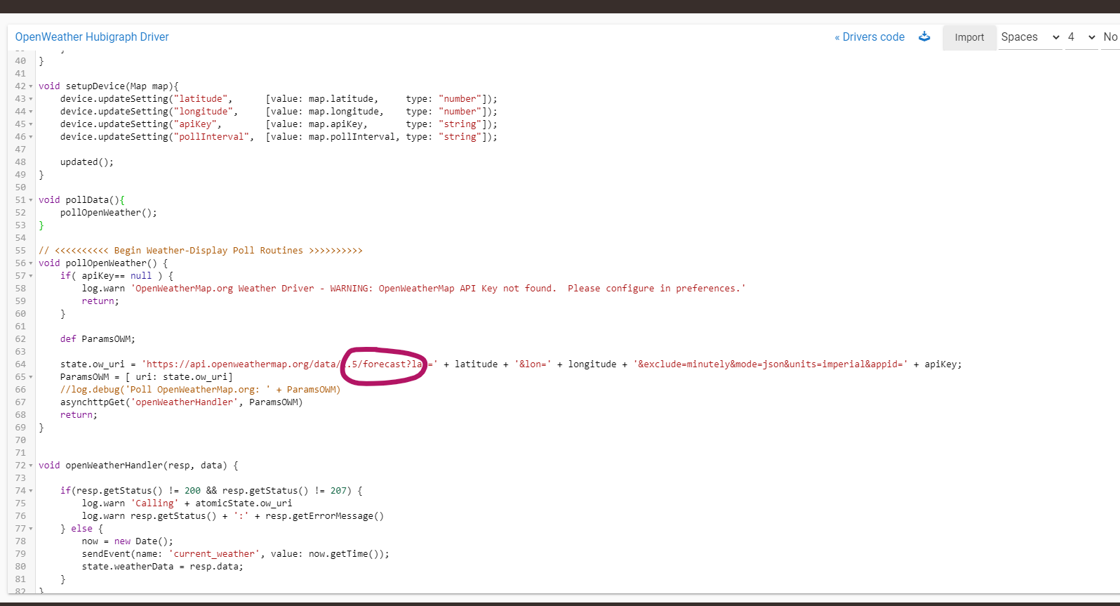

I tried Hubigraphs (got some nice graphs of my own T&H sensors going) but cant get the weather to work. I have an openweathermap API key and entered it in all the places. I get just a blank preview and tile. I think I am missing some crucial step. Used Hubigraphs to create the tile,
I noticed that the Hubigraph weather driver code was looking to the OneCall from OWM, but i think that needs to change to forecast since i only have a free account? Tried that:
Still nada.

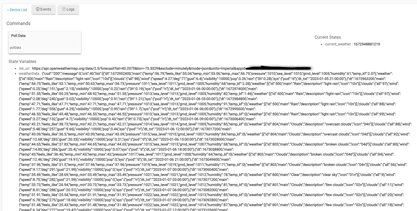

Created a virtual device and its outputting raw data
When i go back into the Weather 2 tile and pick the virtual device it doesnt seem to be pulling the data correctly. Not sure what i am doing wrong here.

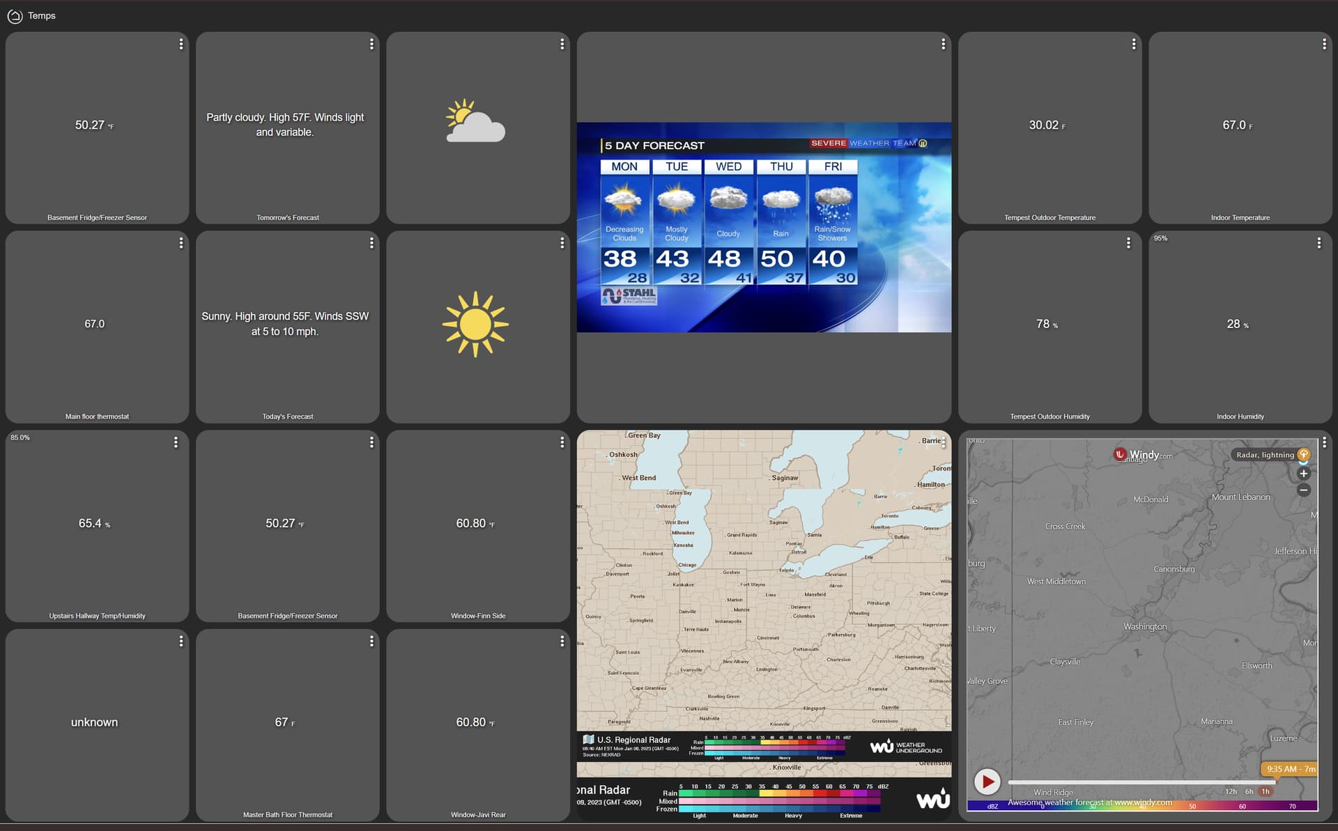

Use openweather map... Hubigraphs is no longer supported.,
I was trying to use OpenWeather Map thru Hubigraphs for the graphics. Dark Sky isnt supported anymore either. What are people using for their tiles instead of these two apps these days? Couldn't find an obvious replacement.
I use Wunderground as well as a Tempest Weatherflow...
