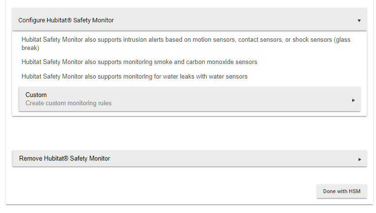

Okay - I get it. My setup isn't working because I'm not actively using HSM. I thought HSM had its own internal settings for away, home, night as ST does but I see that was a bad assumption. Within ST I also don't use SHM but I can still set the SHM status to away, home, and stay. I was trying to do the same here. At least now I know what I need to do. For what it's worth seems to me you would want to have a generic capability to set HSM to away even if you don't have any sensor tied to this mode. Anyway, i understand your design language now and I will adapt my app accordingly.
One person sets "Arm Away" and it shows on the panel. Second person arrives home and sees this set. Tells them the intent of the first person who left. Another perhaps more practical use is if a third party app reads the status of Arm Away that Hubitat doesn't know about. The more practical scenario is for future expansion of HSM use - allowing the intent to be implemented even before the practical application is active. All that said, I get why you did what you did and I'm not even asking it to change. I just found it confusing that it was different than what I expected from how ST works. I know there isn't any love there but my app has to play nice with both and I bounce back and forth so when I find random inconsistencies like this it confuses me. Thanks again for giving me some of your precious time on this. I know how busy you are. I now have what I need to fix my HousePanel app.

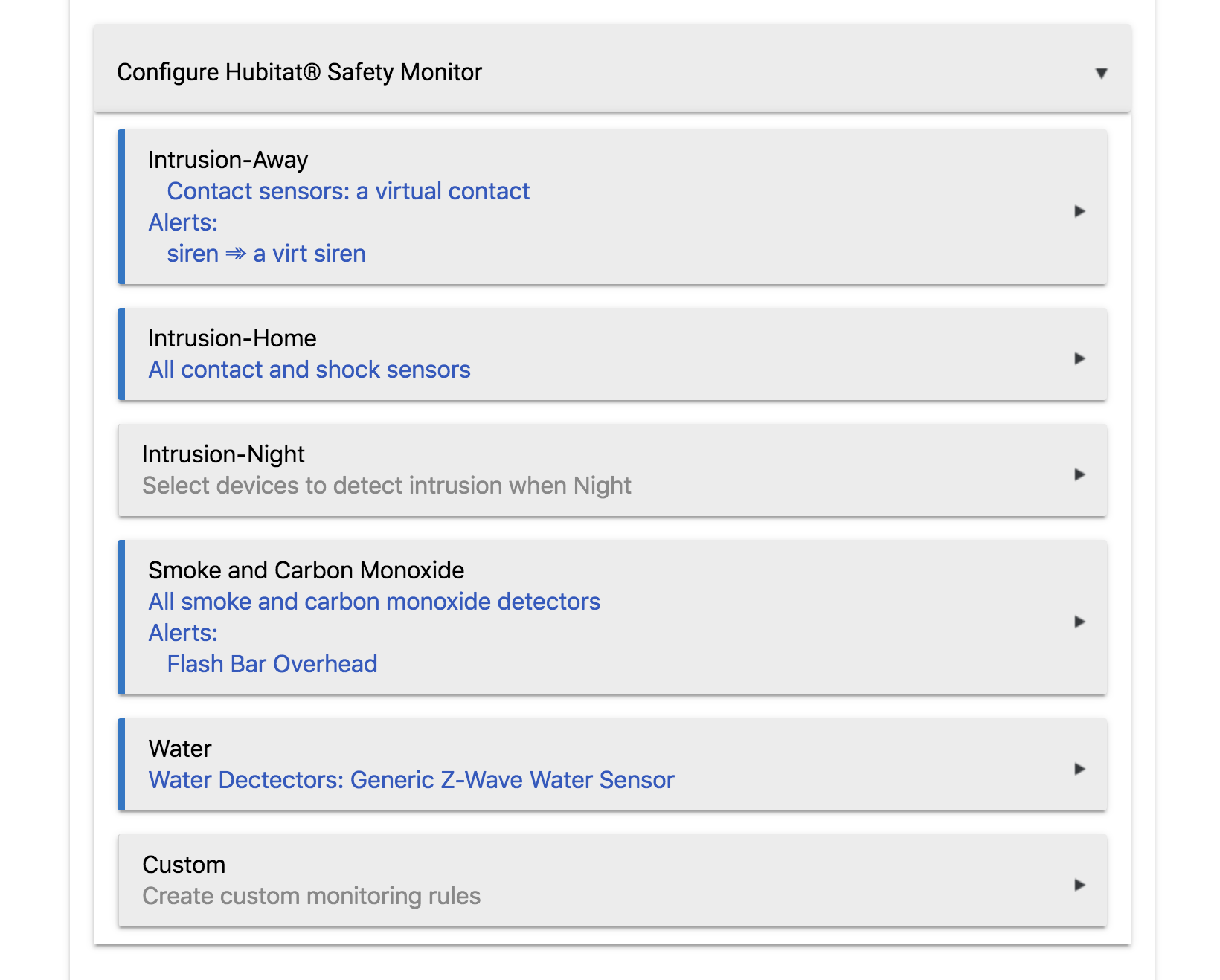

Good idea. I don't have any sensor paired to my Hubitat hub. I'm only doing this to support other users of my app that do. All my sensors are still on the ST side. I will try using a few virtual sensors to see if that makes it work.
Sure enough - once I added a virtual contact everything started working as it should. The arming works and reading the status even works. Thanks all for your help with this.
