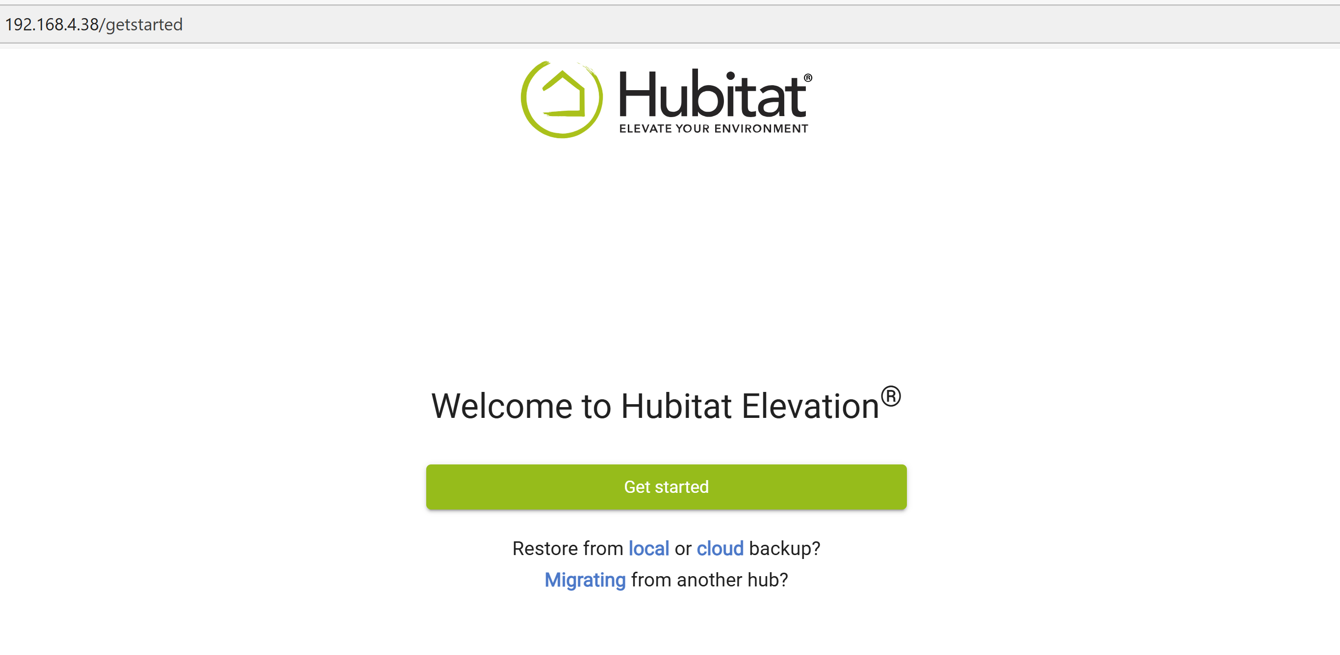

Tried to find it on the new network and I get this:
Does that mean the hub has reset to factory?
I restore from the last backup and start from there?
Or I'm missing something?

Hoping that it’s just a bug. Try removing the /getstarted from the end of the URL and hit return. If it’s what I think it is you should end up at the hub’s main menu.
Removing the /getstarted from the URL, get's me back to the /getstarted page again.
What happens if you go to http://192.168.4.38/hub/edit
If you click on the local link, does it offer to restore from a bunch of backups?
If yes, restore the latest one. Also, please PM me the hub id, I'll check for possible root causes in the engineering logs.
That works but hub definately seems empty as no more devices or apps.
That's the ID but you should send that as a PM and remove it from the thread.
Restored and everything works now.
