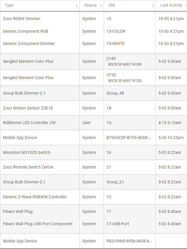

The only Custom Driver I use is the RGB Genie.
Custom-Drivers
Device List

I was thinking the next avenue of possible testing is to remove each device and then check the Ping rates.
Is this a good & sound approach?
If so, is the backup/restore on Hubitat robust enough when I eventually need to do the Restore?
Depending on the number of devices and rules I think I’d try disabling the devices instead of removing them.
