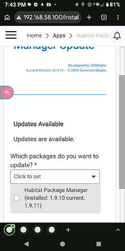

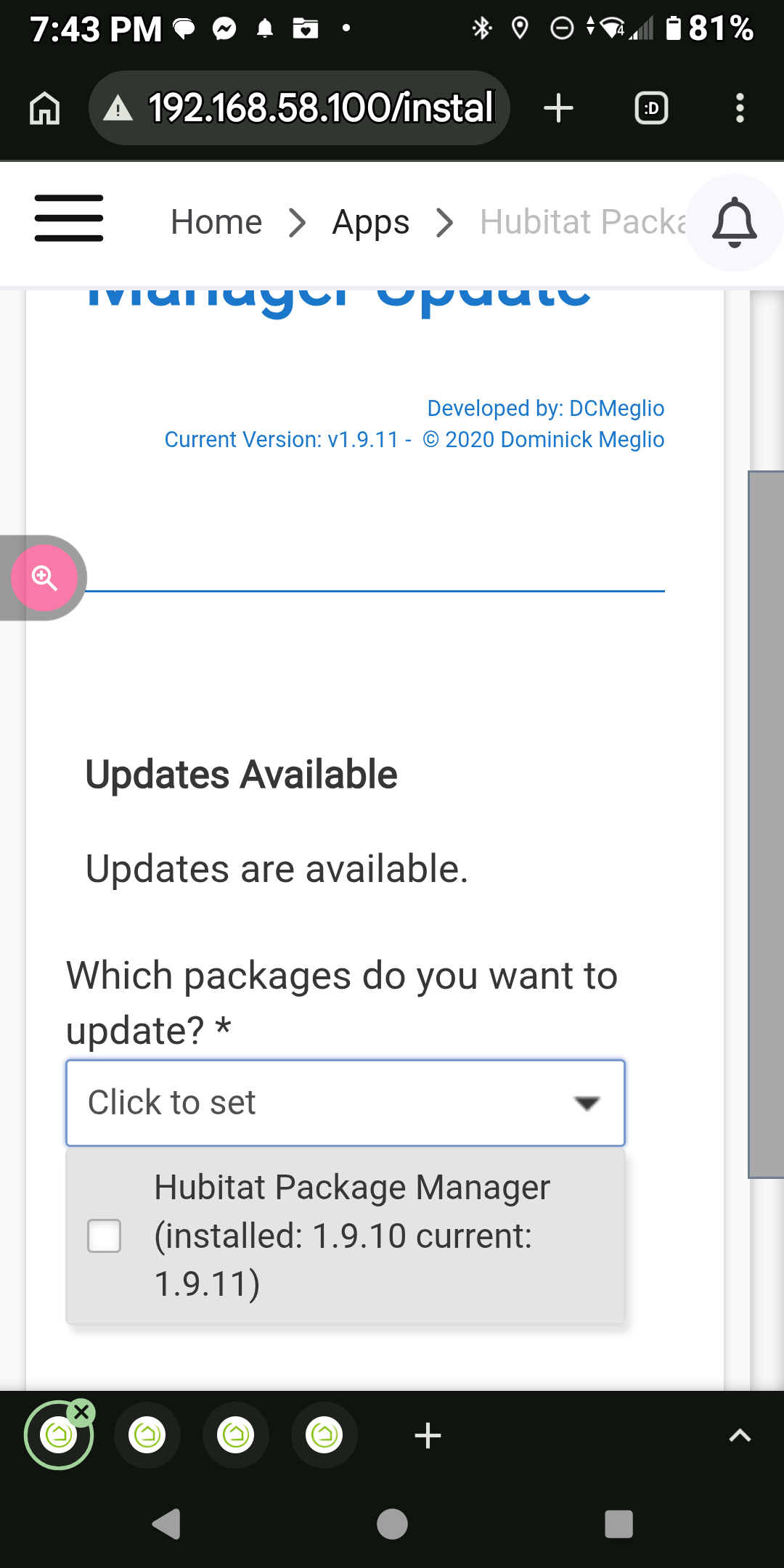

I load it from the apps screen. Then I click on update. It comes up that there is an update from 1.9.10 or something like that. It says the new hpm is 1.9.11. I select it to update it and it says installing update forever. I waited 30 min before I stopped.
Funny thing is, when on the screen to select the hpm update at the top it says I Am running version 1.9.11
Attached is a screenshot.

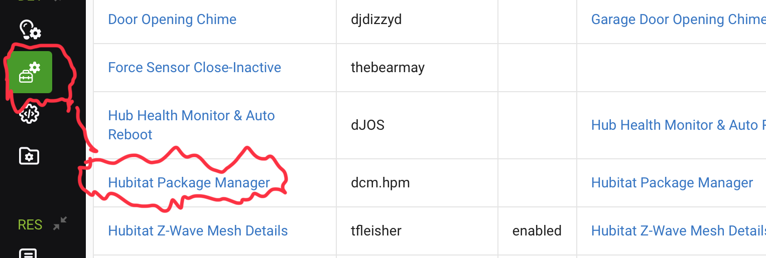

Check to see if you have 2 copies here:
I don't have that icon, but if it's apps, I have only one there.
Check in the apps code page (not apps) for two instances of the HPM app code on your hub.
There is but one there, as well. Not two.
