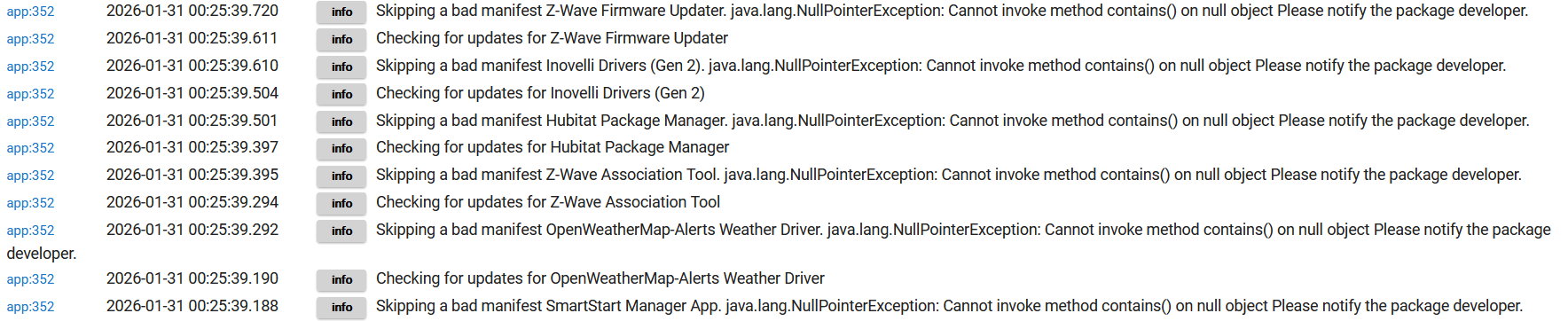

All repositories fail:
Skipping a bad manifest XXXX. java.lang.NullPointerException: Cannot invoke method contains() on null object Please notify the package developer

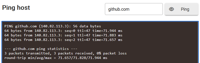

As recommended on another old thread, I've tried static IP and manual DNS server with the same outcome. Github.com ping works:
What version of hpm are you running?
v1.9.7, I thought it updates itself too, I've updated to .8 and it resolved the issue.
