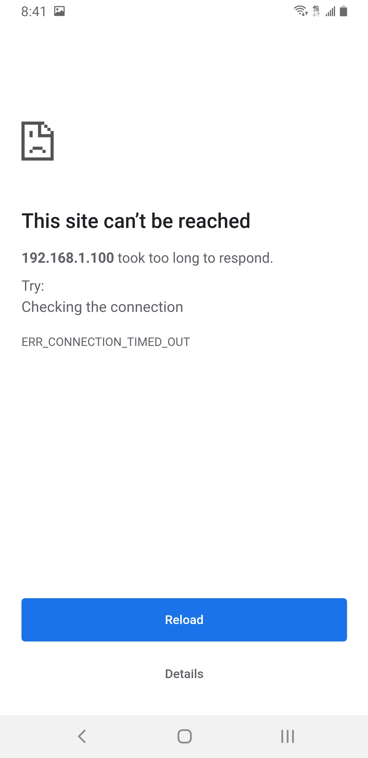

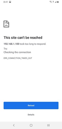

Hubitat not working this morning for no apparent reason
Not working this morning.
Reset router.
Power cycled Hubitat.
Reset router.
Not working.
:cry:

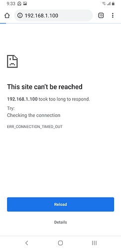

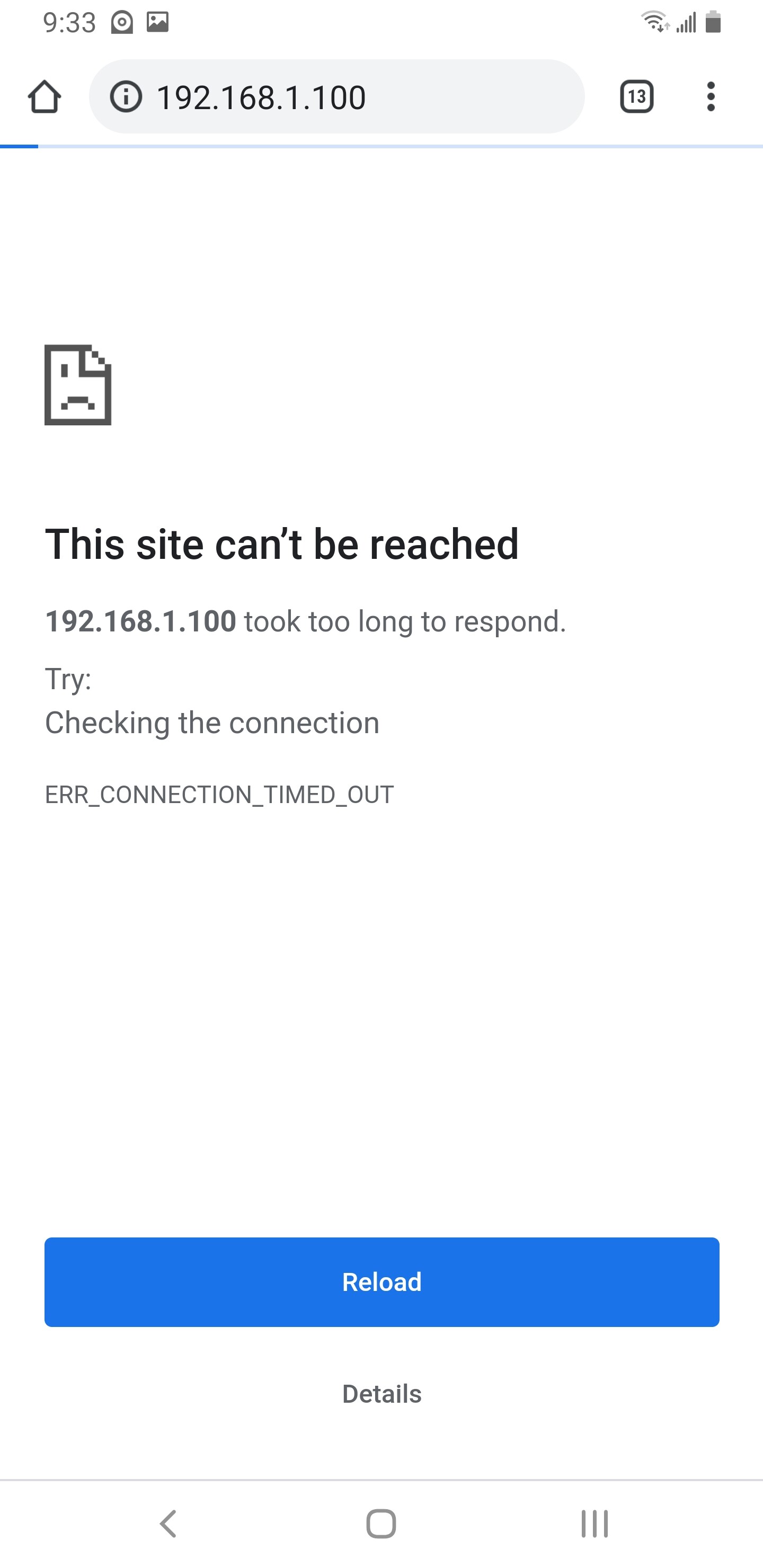

HE7 with green light on.
I powered everything down.
Powered on the router.
Moved Hubitat to different port on the router.
Powered up router. All working well.
Powered on HE7 to green light.
Router sees Hubitat on new port on 192.168.1.100
Used advanced find.
Advanced find found Hubitat at 192.168.1.100
Working with Alexa but not local rules like motion sensor triggers for lights.
Hmm. Can you reach the Diagnostic Tool at port 8081?
If you can, then I suspect your Hubitat has database corruption and needs a "Soft Reset".
Back in!
Thanks.
I'm not sure what fixed it but something did.
