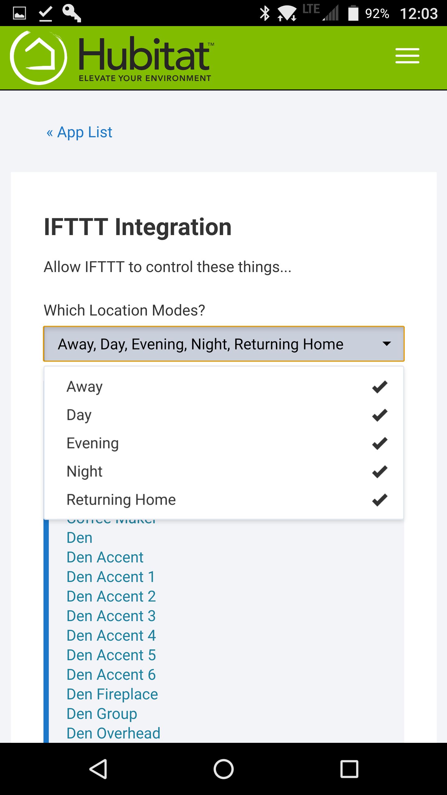

I'm trying to set up my Blink cameras to arm when the mode in Hubitat changes. This seems easy to do, but there are no modes available in the modes drop-down in the IFTTT applet.
Has anyone experienced this? Any ideas?

In the IFTTT Hubitat app there is a drop down menu to select which modes you make available to IFTTT, just select which ones you want to grant access to.
Indeed there is, it just doesn't list any modes to choose from. It only says 'Options Unavailable'.

You need to first select the modes in the integration App in Hubitat before you try and make an applet.
EDIT:
Any modes you select should then be visible in IFTTT under a mode action.
Ok, great. I'll try that.
Thanks for your response!
@Christopher is probably right. If you didn’t install the IFTTT app in your hub’s apps page, that’s likely your problem. Wouldn’t matter whether you use the canned IFTTT applet or you put one together yourself.
That was it! Thank you both for taking the time to respond to you.
