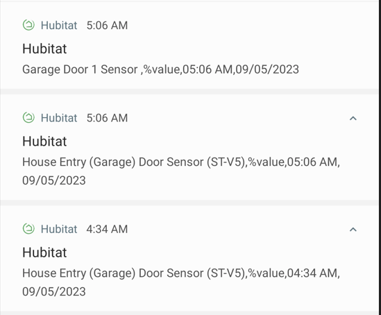

Not sure what app is sending me this message and I'm not getting the device status correctly. Any ideas where I should look? Thanks.
Go to the devices page and click on each device you see in those notifications. At the bottom of each device page, you should see the app/s that device is used in.
Similarly to @jkudave 's recommendation, you should hopefully see relevant information in the Events page for the same mobile device.
I should clarify that comment... You should see the app responsible for the notification in the Events page.
Given that it contains the text %value I'd say it's probably a rule that you have set up.
Missing the second % on your %value% ...? ![]()
You may also add
%device%,%value%,%text%,%time%, and%date%to include these built-in Notifier variables in the message. These refer to the name of the “triggering” device, the event/attribute name (e.g., “switch”), the time of the event, and the date of the event.
I believe it's the default hubitat app, or at least on my android that's what sends notifications. I also get notifications from Nyckelharpa , an HSM addon
The missing % was in Hubitat Safety Monitor. Thank you for the assistance everyone!
