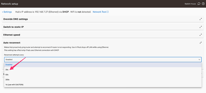

Not sure why it would be related to a hub update but you might try setting auto-reconnect to 30s and see if that helps,

It's not on your router - it's on HE under Setup > Network. Best not to try it on your way home from the pub :slight_smile:

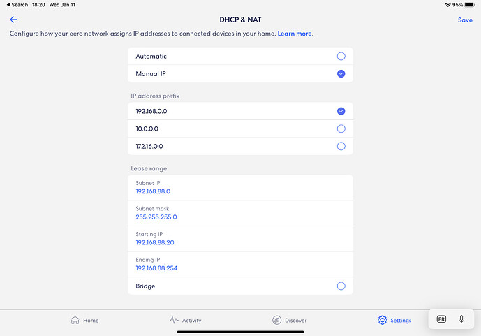

@hydro311 does it create a /24 network (subnet mask 255.255.255.0) or something else?
Also have an Eero Pro 6 with mesh. If I’m not mistaken, you can configure the subnet to whatever you want from the network settings screen:
Thanks. If those are more or less the defaults I think what I read was wrong and OP is likely using a /24 network. On to other possibilities!
