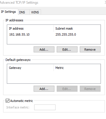

Here are two screen shots of NIC 1 which is on the 192.168.55.xx subnet.
TCP - General
TCP - Advanced

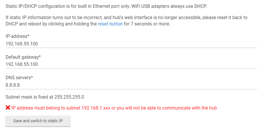

See the message in red from the network setup page on the C7 hub when attempting to setup on 192.168.55.100.

That is what one would expect would happen with the C7 hub when moving to a different network. The plan is how can one trick the hub into moving from one network to another? Or the other side of the coin, is that the C7 hub was never designed for this type of operation or there is an error in the TCP setup.
That's the problem, no gateway. 192.168.55.x has no where to go so the only thing it's going to ever see is stuff on the 192.168.55.x network because there is no return route back to the querying network. In order to see the other side you need to set routing using ROUTE. Once again, this isn't because of the device(s) this is because of the design of TCP/IP...If you are able to see the camera on the new network that is because it's now on the same physical segment it was. If you move that camera physically to the .55 side of the nic then you will not see it from the .1 side without there being a default gateway. A lot of what I'm saying is being oversimplified but trust me when I say, the way you're trying to set things up isn't going to work the way you want to.
