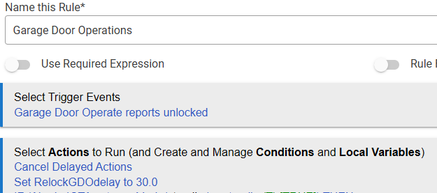

trick it. Make a virtual lock. Use the virtual lock to trigger the zen16. Share the Virtual Lock with Google Home.
Then do what you need to in the triggered rule. For mine, all I asked it to do was pause for an are sure Y & N button to be pressed. See what Google can do with that. I don't know for sure as that device is not shared with my Google Home.
