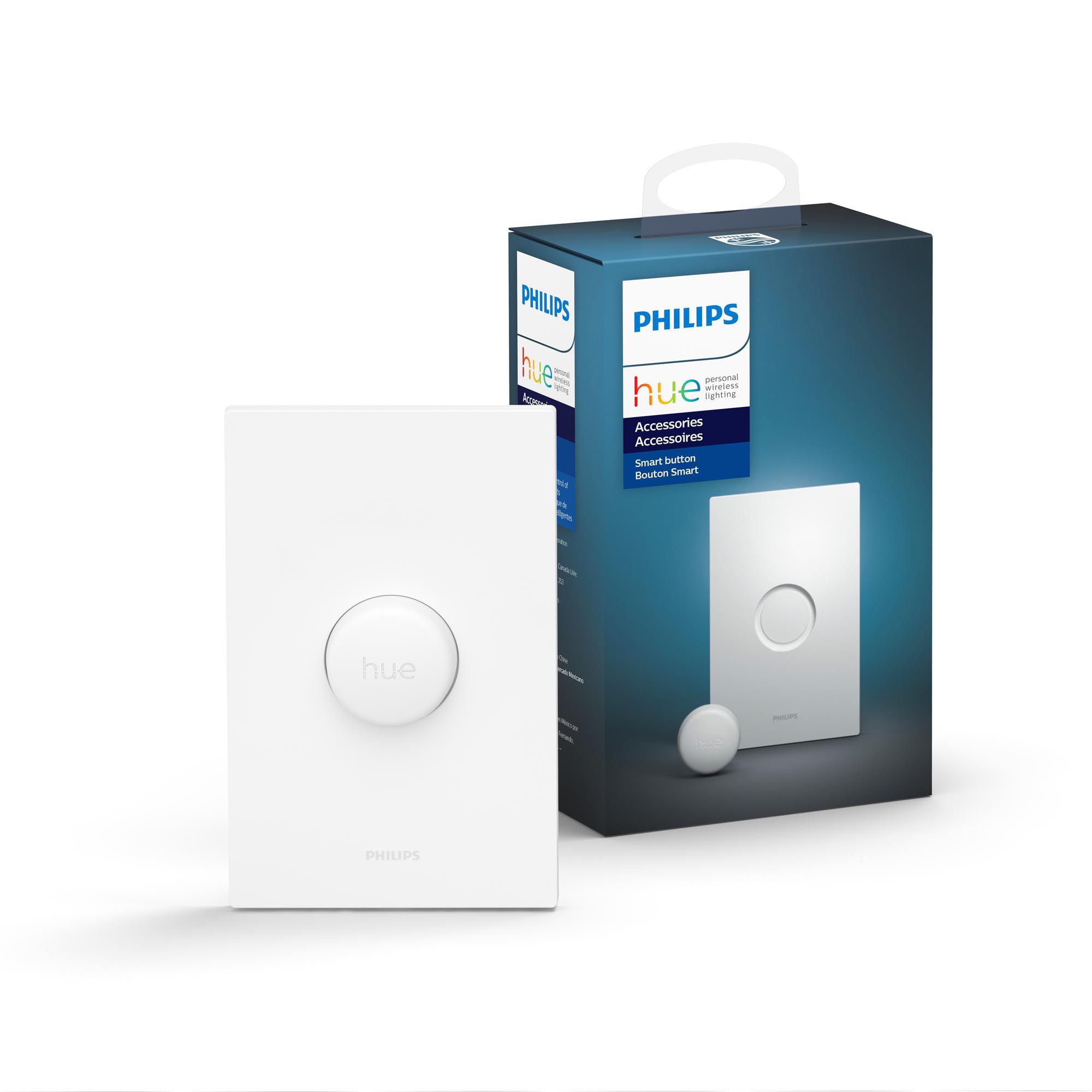

Is the Philips Hue Button 2019 supported? I don't see it in the matrix of the first post.
Just ordered a couple of those with a couple of Osram Switch+ and one Switch Mini, that I believe are supported through the Lightify Smart Switch official driver.
Hope to have everything supported by HE.
Yes, the official list is a bit stale.
