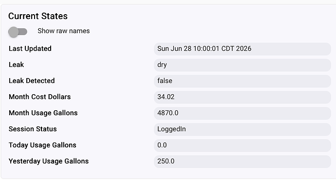

Hubitat driver for the Dropcountr smart water meter platform
This is vibe code, created by Claude AI and optimized by Google Gemini.
My local utility uses the Dropcountr platform to connect to their smart water meters so users can track their water usage using the mobile Dropcountr app.
Dropcountr does not have an official public API. I wanted to import Dropcountr data into Hubitat to create actionable events based on water usage. So I used several iterative cycles of Claude AI to create a Hubitat driver for a reverse-engineered Dropcountr API. I then used Google Gemini to optimize the code created by Claude AI. A virtual device created using this driver will pull in data from Dropcountr at the specified interval (15 mins to 4 hours). The virtual device will have the following states:
To install:
  1. Create a new Hubitat driver and paste the code into it. You can also directly import the raw URL for this driver. Save the driver.
  2. Create a new virtual device and assign the "Dropcountr Water Monitor" driver to it.
  3. Open the device, go into Preferences and enter your Dropcountr app username/password. You can also set the poll interval.
  4. Click the "Initialize" button on the device page.
If all goes well, you should start pulling in data.
Dropcountr Water Usage Driver for Hubitat - Optimized Edition (with Fixed Leak Detection)
Features:
Login / session cookie management
Cached API templates to reduce redundant lookups
Fixed scheduling options (15m, 30m, 1h, 2h, 4h)
Native Hubitat "LeakSensor" capability mapping (wet/dry states)
Only commits database state changes when attributes actually change
Author : Custom / Optimized
Version: 1.2.0
