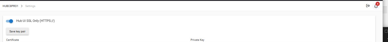

This is because I have https only enabled on the hub also. (I also have a custom certificate installed, and at first I thought that was the issue, but its not).
If I disable https only, it works.

if you enable https only for ui, you can see the fail... but "unknown error" .
