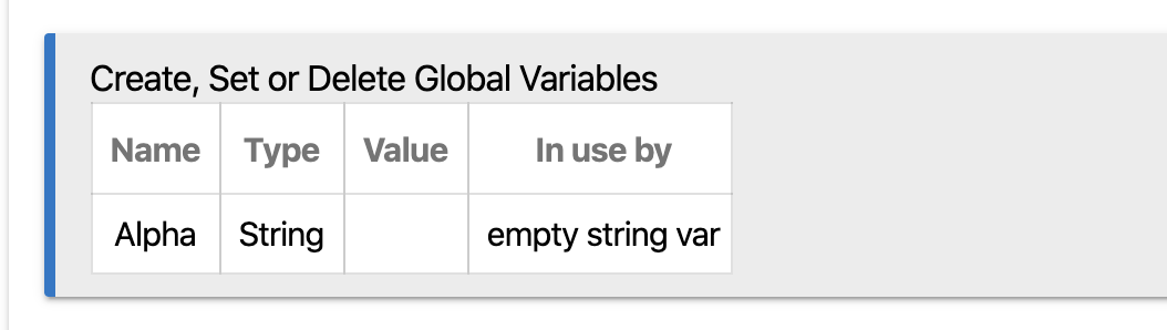

I know that Rule string variables set to "null" don't show up on the normal variable listing in the Rule, although they're still there, and can be set or deleted normally.

How do you create an empty string variable? The documentation states you have to initialize it and the UI requires a value. I have tried various things but can't seem to figure it out. If I put in null does that represent a null value or the string 'null'?
How do you set a value to null or empty string within a rule? I have been creating the variable with a space in the name and then removing the space within the rule.
You cannot have a null variable in RM. It won't like it. Why do you have to set a variable to empty? You won't be able to compare it to anything or use it in any way until it is set to something. You can't compare null to anything, you'll get an exception error.
Because I was building a list and want to be able to set it to null or an empty string. I can get around it but it would be easier if I could set an empty string. The following works:
Edit: vTest was initialized with a space. It can be whatever you want.
Remove ' ' from vTest
IF (Variable vTest() *is empty* (T) [TRUE]) THEN
