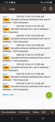

Hubitat Dashboard started throwing errors this morning. I updated the system last night. Any suggestions?
A dashboard tile has a limit of 1024 characters including all attributes of the device even if they are not displayed. If you have a device used by a tile that has a really long list of attributes this warning can appear. Even if you didn't make a change to the dashboard itself one of the attributes on a device may have changed to push you over the limit. Device Watchdog by its very nature can have a long set of attributes so if you use this app that may be what's driving the warning,

The bathroom light turned on when this happened and that tile was two columns by two rows instead of my usual one column by one row so I set it to the usual size. That may fix it. It all makes sense.
Thanks again!
Welp. No more errors so far!
It's the size of the data elements behind the tile, not the size of the tile itself. If it's fixed it's a coincidence. Sorry! But at least it's fixed.
I also deleted another tile I wasn't using. We can say it was that one, then. Still no more errors!
