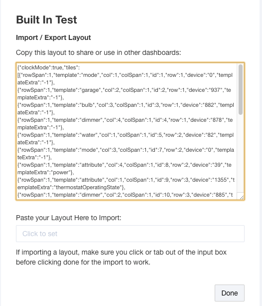

Can you go into the Dashboard and then go into Layout Options, import / Export and post the json like below:
Something is not right in your dashboard. The layout should tell us.

​Here are the layout options you requested:
{"clockMode":null,"tiles":[{"rowSpan":1,"template":"generic","col":1,"colSpan":1,"row":1,"id":0,"device":"69"},{"rowSpan":1,"template":"generic","col":2,"colSpan":1,"row":1,"id":1,"device":"70"},{"rowSpan":1,"template":"presence","col":3,"colSpan":1,"row":1,"id":2,"device":"78"},{"rowSpan":1,"template":"generic","col":1,"colSpan":1,"row":2,"id":3,"device":"77"},{"rowSpan":1,"template":"switch","col":2,"colSpan":1,"row":2,"id":4,"device":"98"},{"rowSpan":1,"template":"motion","col":3,"colSpan":1,"row":2,"id":5,"device":"97"},{"rowSpan":1,"template":"illumination","col":1,"colSpan":1,"row":3,"id":6,"device":"76"}],"bgColor":"Black","lanRefresh":2,"background":"","name":"AutoPopulated","readOnly":false,"cloudRefresh":5,"rows":"4","cols":"3"}
