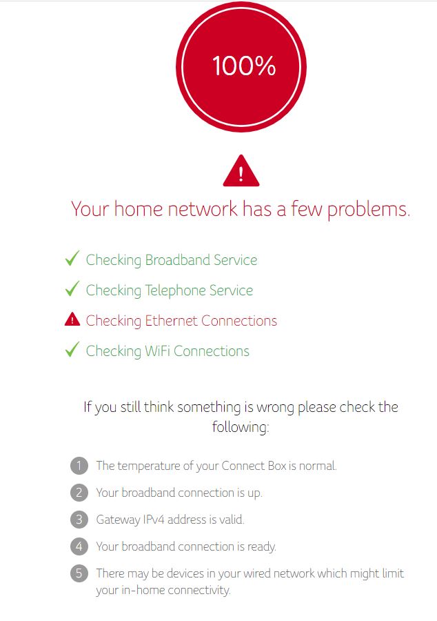

Hi,
Why would my internet service provider router diagnostics, generate an error when the Hubitat is connected?
Background
  • The router provided by my Internet provider has a Network Diagnostic tool.
  • One of the tests is "Checking Ethernet Connections"
  • When the Hubitat is not connected, the test completes with 100% success
  • When the Hubitat is connected I receive the message "Your home network has a few problems."

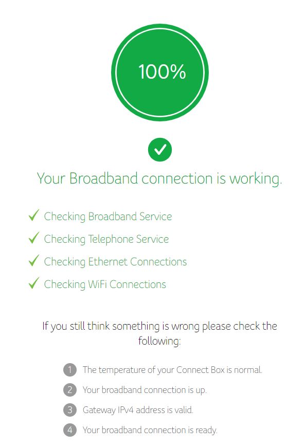

Update
  • I repatched the Hubitat into a switch which is connected to the router and the diagnostics test is now successful, which for me is not optimal but I can live with it
Answer to queries
  • auto-negotitate : in Network Setup I changed the setting for internet speed from "Auto Negotiated" to "Fix 100mbps" and back again. Test result was the same
  • Fixed IP : Hubitat has a static IP address and is not using DHCP. On the router I have reserved a range of IP number, so that I can assign a fixed IP number when required. I have verified that the assigned number is within this range and also confirmed that the number is not assigned to another device.
  • Router port Speed - I have not been able to find a way to change the port speed on the router
Find attached samples of a failed diagnostics test and a successful one.
I'd bet my next paycheck that they hard coded anything below 1 GB as being a "problem."
It should auto-negotiate down to 100mb which the Hubitat runs at.
@user2845
What @FriedCheese2006 has written is right on the mark! The "error" provided by your router's interface confirms it ....
Error with Hubitat
Hubitat's ethernet interface is limited to 100 Mbps, which is more than sufficient for its use, and off course, this will have zero impact on the rest of the devices on your LAN.
But your router doesn't know that the Hubitat hub is not something like an ethernet switch. And, if it were a switch, the 100 mbps interface would be limiting for all the devices connected to that switch - especially if those devices were capable of gigabit networking.
If I were you, I would connect the Hubitat directly to your router, ignore the error, and go on using it. It will have zero impact on your LAN. In this instance, that error is irrelevant.
