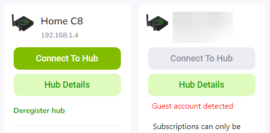

If you go to My Hubitat and then Registered Hubs do you see both hubs? Both would need to appear like this example on the left side, indicating they are both registered to the same account. If either is showing a guest account (like right side of example) then the migration will not be seen.
