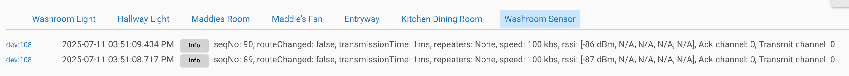

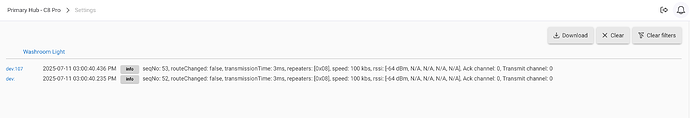

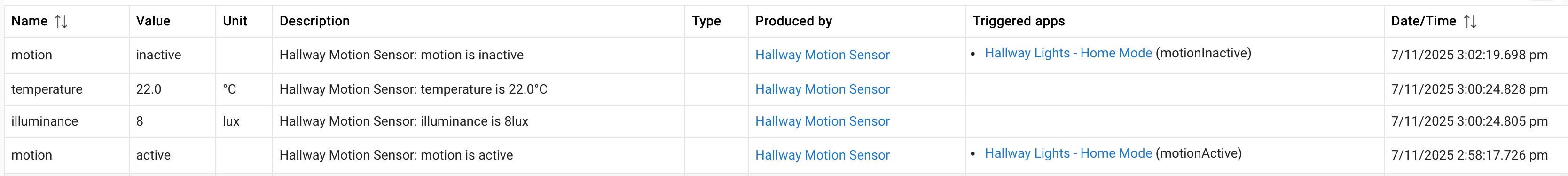

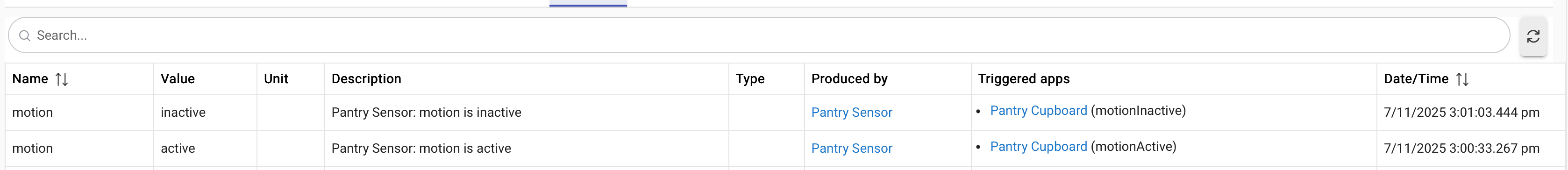

Yeah that is weird - I just went and triggered zwave 4 sensors, and only the washroom light turning on registers in the zwave logs. All the device events are there, and all automations worked correctly (the washroom light is the only zwave switch being turned on).
Zwave Logs:
Device events:

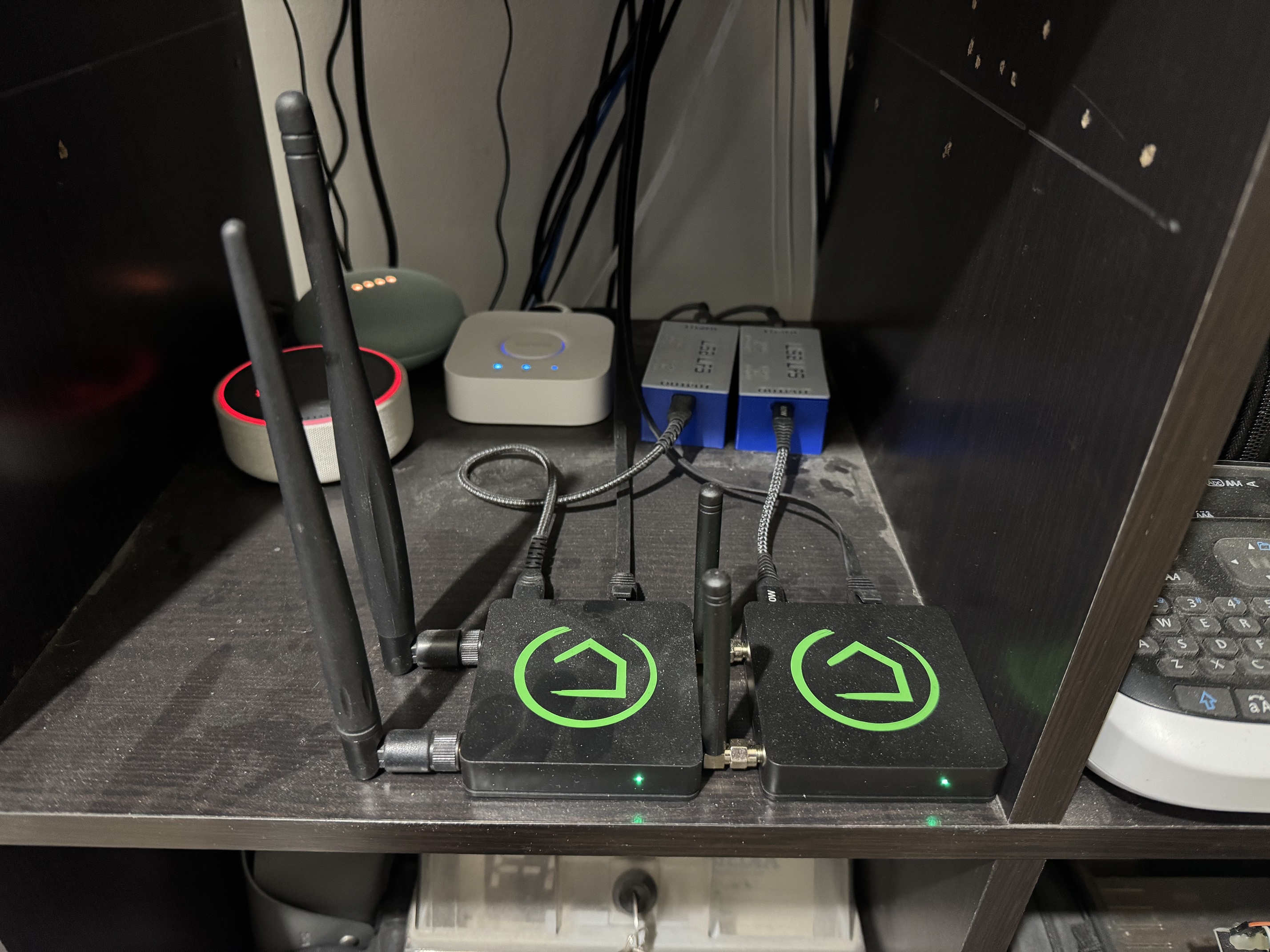

No, because I'm running higher quality/dBi antennas on my "radio" Hub (from back when some of us modded our C7's with external antennas to improve performance). The secondary is just running the stock antennas - it's also intentionally dedicated to my extremely active LAN/Cloud devices, and the radios are disabled.
"Lesser used" is also not accurate, it works almost as hard as my Primary hub.

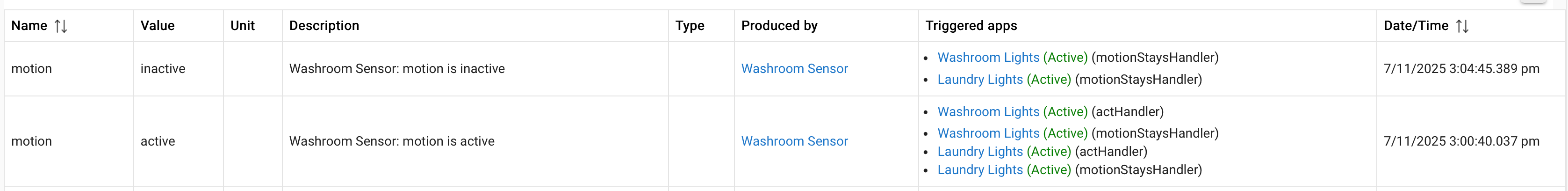

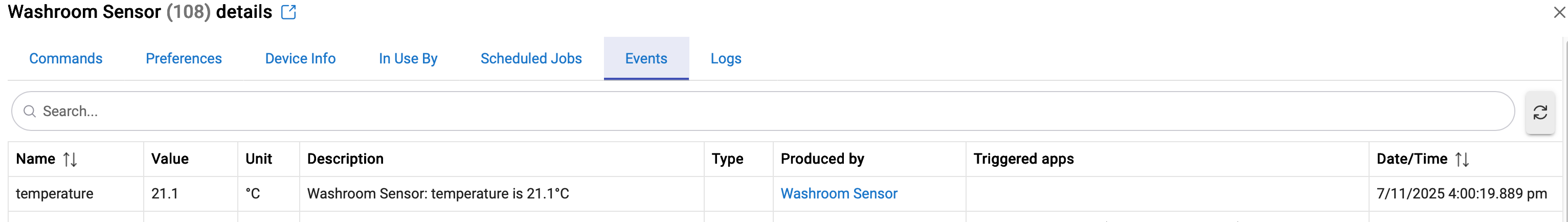

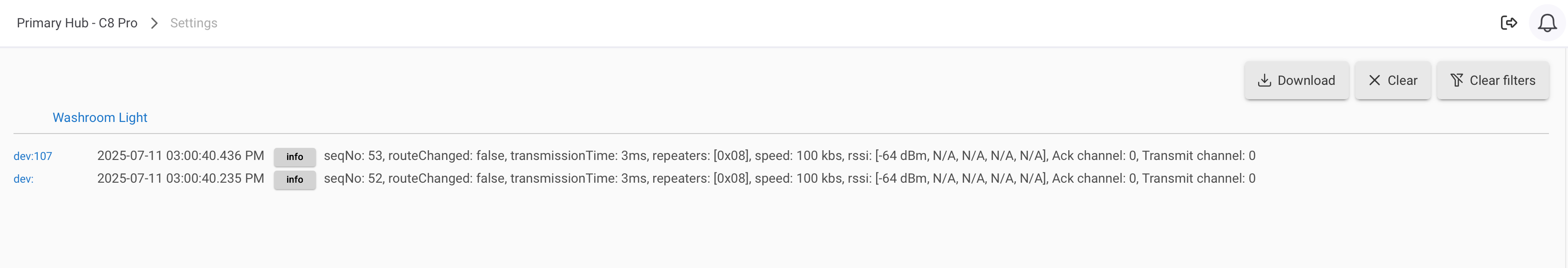

So I left the z-wave logs open for an hour, and finally saw a sensor appear in the list:
But it wasnt a motion event, just a temp reading:

Yeah, antennas aren’t my problem. :sunglasses:
Zwave: 900MHz 5 dBi Rubber Duck Antenna HG905RD-RSP
Zigbee: 2.4GHz 5.5 dBi Rubber Duck Antenna HG2405RD-RSP

Factory ducks are dual band. Yours are not. How do you know which antenna goes on which port as the antenna connections are not labeled. I was of the mind to think both ports were dual band which could allow for some beam forming like WiFi does.
On both C8 models, the z-wave antenna is the one closest to the usb-c port.

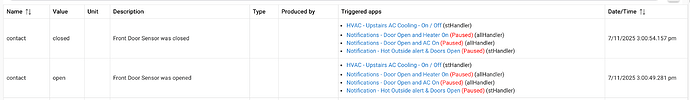

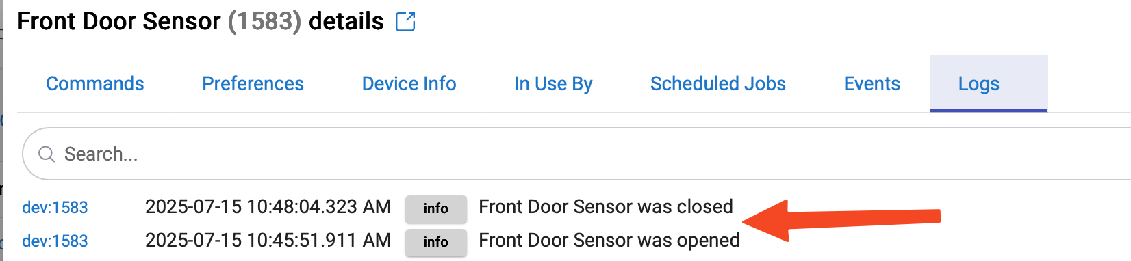

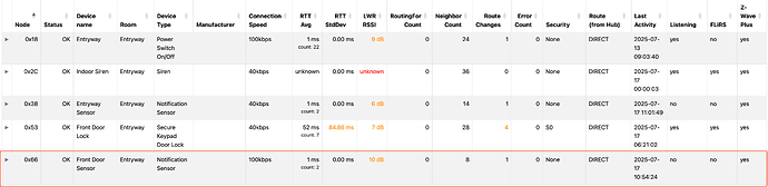

Argh, I spoke too soon, I just had a missed contact sensor event! :weary:
I had to re-open and close the front door because Habitat thought it was still open (it wasn't).

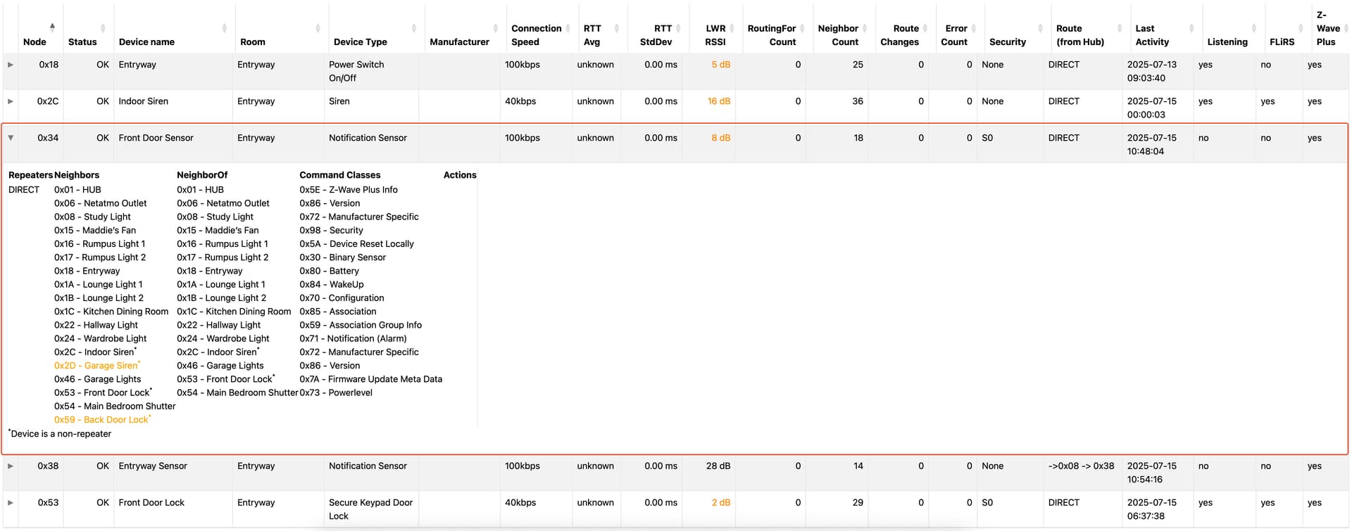

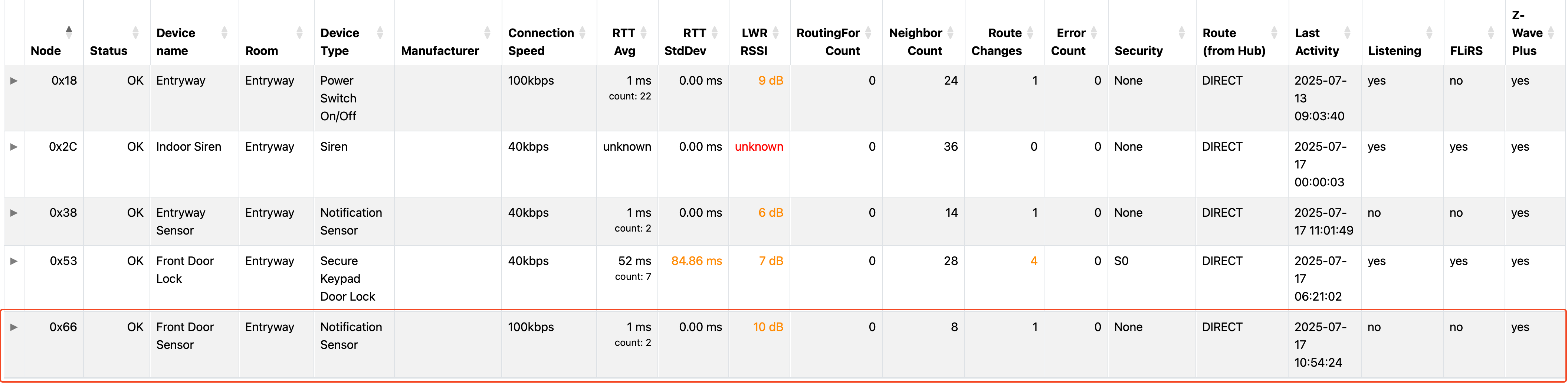

Z-Wave info:
This unit is a gen5, so I might upgrade it to a gen7 and see if that helps.
So yesterday I replaced this sensor with the zw700 series version - signal strength has jumped to 10dB, from 8dB. I have no idea if that will cure this sensor's missed events, but I guess I'll find out.

No idea, so far, the 700 series is working well - the signal strength even went up from 10dB to 12dB somehow.
