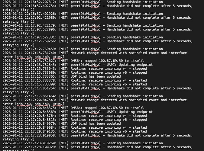

NET] UDP bind has been updated
2026-01-11 22:13:13.683556: [NET] Routine: receive incoming v6 - started
2026-01-11 22:13:13.683595: [NET] Routine: receive incoming v4 - started
2026-01-11 22:13:18.526772: [APP] Status update notification timeout for tunnel 'mm'. Tunnel status is now 'connected'.
2026-01-11 22:13:18.709821: [NET] peer(9tWH…dMyw) - Handshake did not complete after 5 seconds, retrying (try 2)
2026-01-11 22:13:18.709949: [NET] peer(9tWH…dMyw) - Sending handshake initiation
2026-01-11 22:13:23.901233: [NET] peer(9tWH…dMyw) - Handshake did not complete after 5 seconds, retrying (try 3)
2026-01-11 22:13:23.901460: [NET] peer(9tWH…dMyw) - Sending handshake initiation
2026-01-11 22:13:28.912367: [NET] peer(9tWH…dMyw) - Handshake did not complete after 5 seconds, retrying (try 2)
2026-01-11 22:13:28.912581: [NET] peer(9tWH…dMyw) - Sending handshake initiation

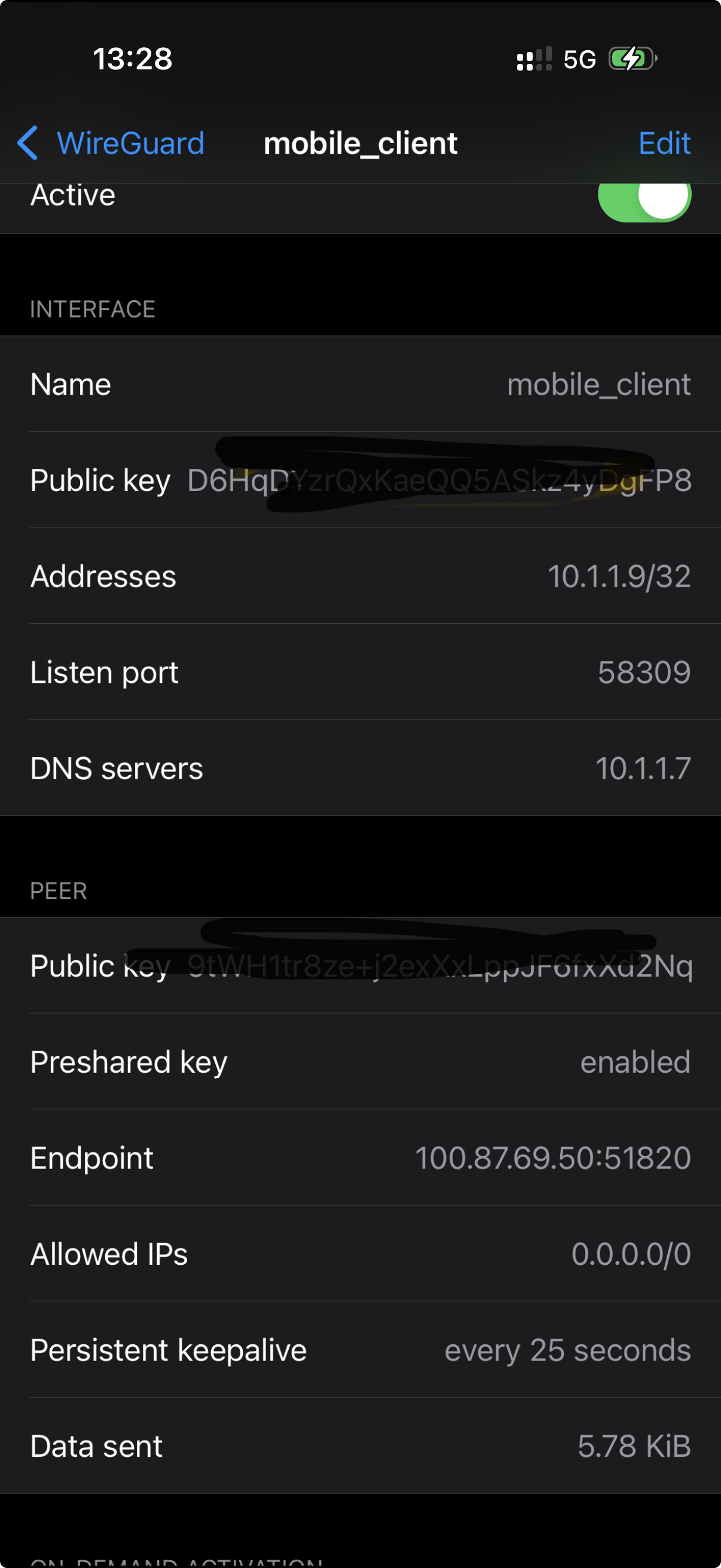

I am confused by the endpoint of 100.87.69.50 on the iPhone client.
That address is reserved for CGNAT. LINK.
It is not routable over the global Internet. And yet the router logs show that the request to connect arrived, but only the handshake failed to complete.

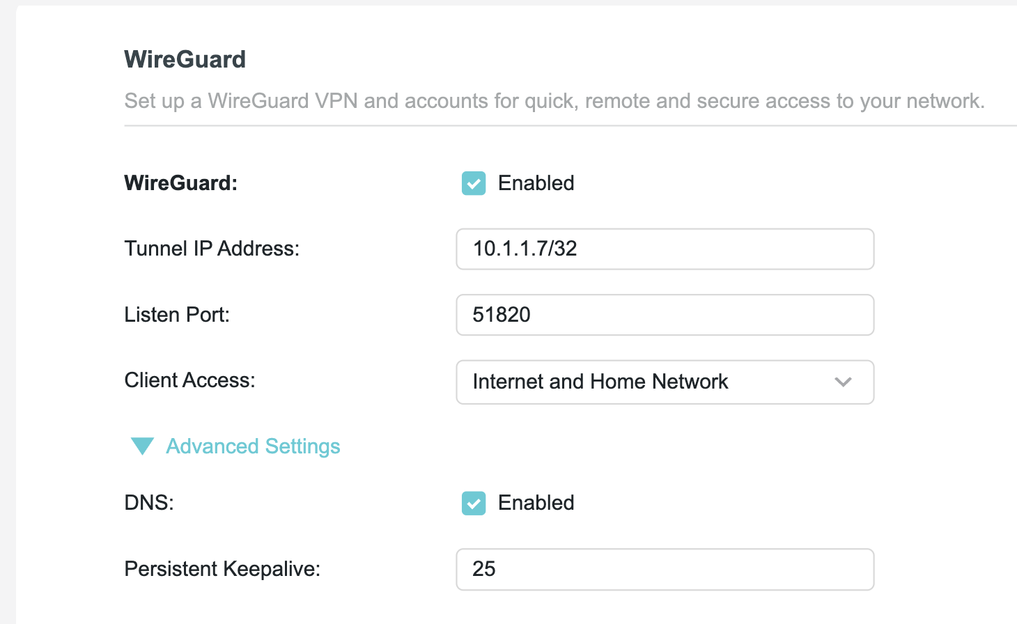

The TP-Link instructions to configure Wireguard server on their routers is pretty straightforward.
Search your ISP site for how to configure your gateway/firewall for Wireguard access.
Hello , I have to test the connection with client, I disabled the firewall in to link. My router is directly connected with you fibre. As you said , I am using all straightforward Parmeters whatever router client configuration. Only the change I am doing, I am replacing the endpoint with DDNS NAME ; port for the VPN server.

Hello , I am replacing that ENDPOINT with DDNS . Iam using tp-link proprietary DDNS service to internally configured with domain address. After placing that address and saving client configuration, it will translated to the as in screenshot.

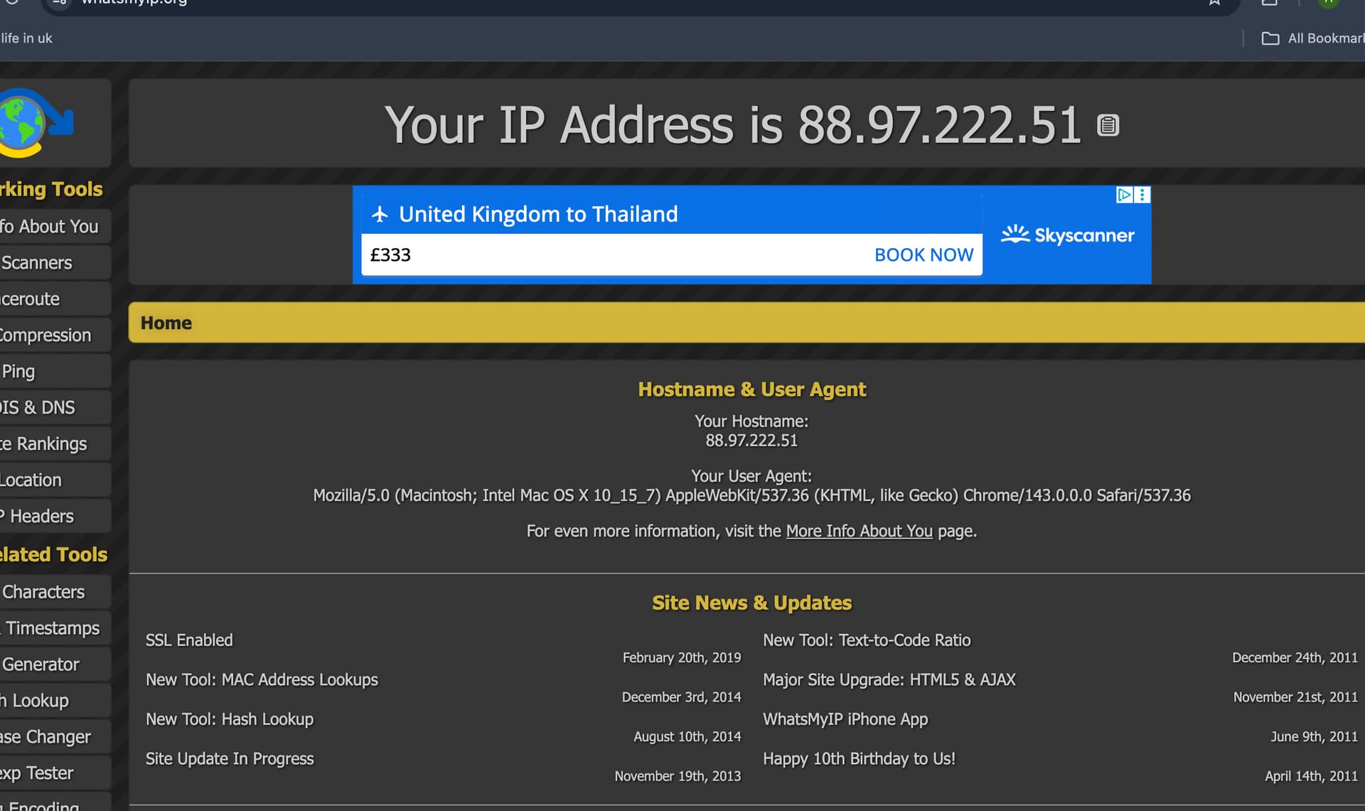

Go to http://whatsmyip.org and see if the address shown matches the address you are setting the iPhone client to. The address returned will almost certainly be different , since as I said that address is a CGNAT address

i checked it seems to be same address i am pointing client and whats my ip returning the same.
@marriage0280
The problem is you appear to be behind two NAT's.
It looks like the public IP you are behind is 88.97.222.51. Then your personal router is behind a 100.87.x.x address.
