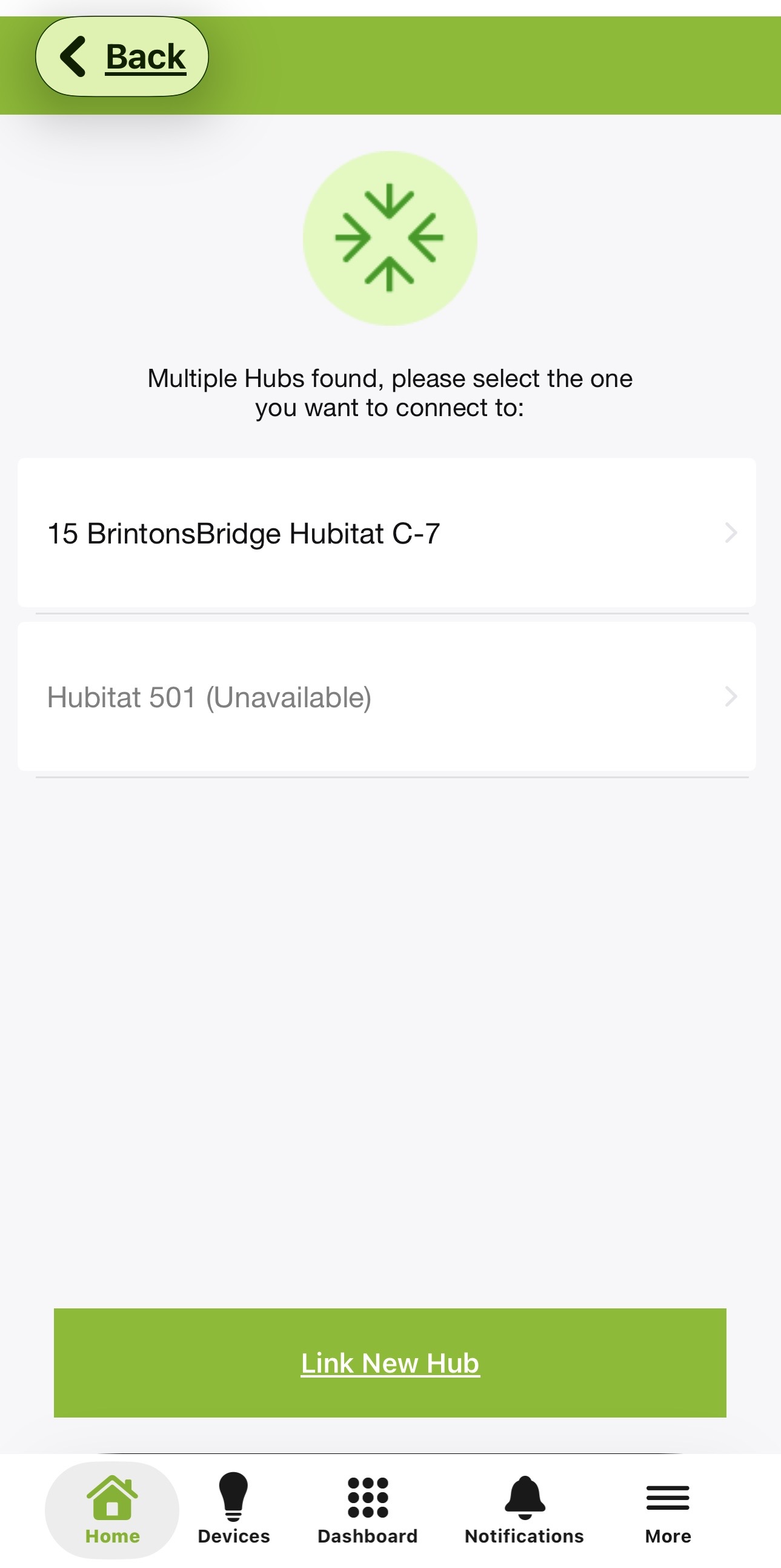

Cannot connect to my C8 hub through my iPhone app. I have a iPhone 14 Pro Max on iOS 26.1

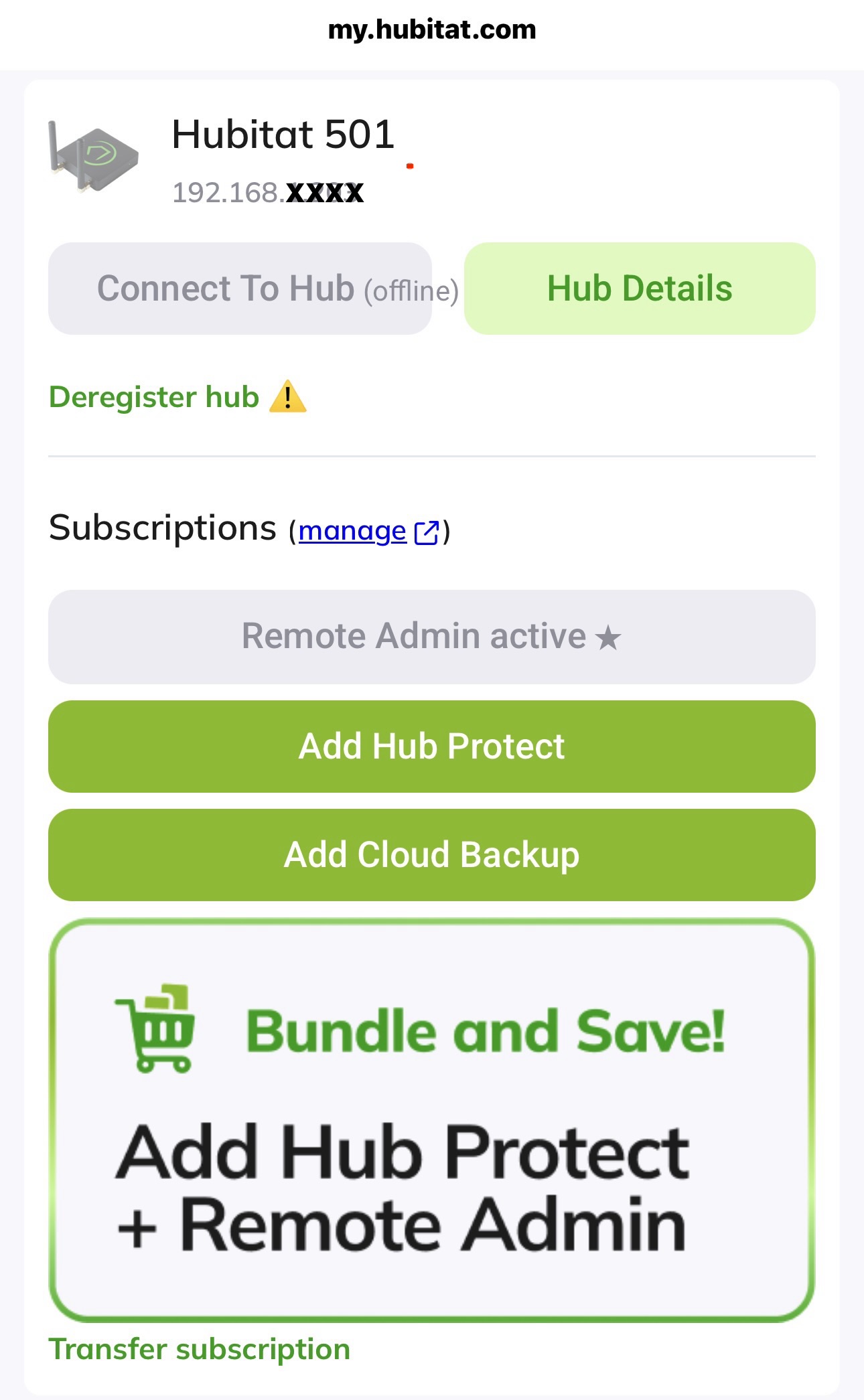

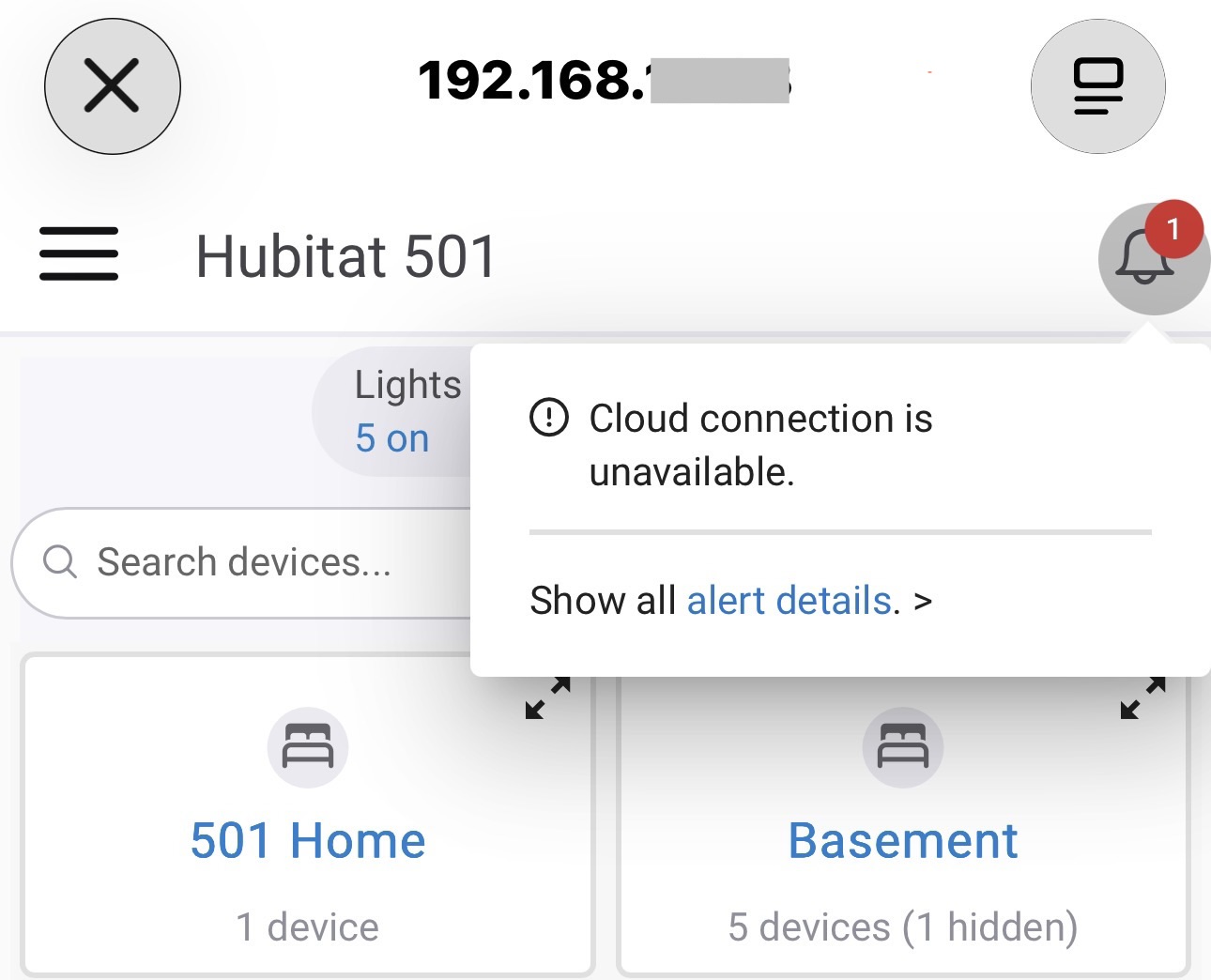

So the issue appears to be that your hub can’t reach the cloud (aka the internet), according to your last screenshot.

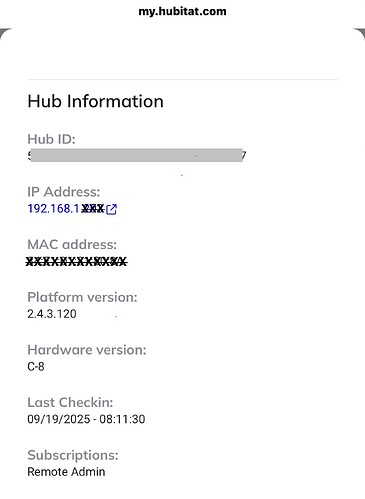

However, your second screenshot contains your HUB ID and MAC address. You should redact both of those pieces of information from your screenshot so no one else can see them.

It looks like Hubitat 501 did have Internet access on September 19. Can you confirm that your C8 has been working normally up until that date?

Is your 15 BrinstoneBridge hub on the same LAN as Hubitat 501?

The other hub is at a different location and works fine through the app.

Is the hub’s last check-in still showing as 9/19/25?
Do you mean that you can access the hub from a web browser running on a device connected to your home network? What URL did you enter into the web browser? Did you try connecting by using the IP address?

“Is the hub’s last check-in still showing as 9/19/25?“ YES

Unfortunately, there isn't much we can do remotely to troubleshoot cloud connectivity issues. One thing to check, if you didn't already, is the "Hub Time" on Hub Details page. Worth updating from browser and waiting for a few hours to see if the hub connects to the cloud.
Also, since your hub is running a beta version prior to 2.4.3 public release, I would try restoring the 2.4.2 version to see if that fixes the problem. Version 2.4.3.120 was available in beta for just one day (Sept 18th - Sept 19th) and had some networking enhancements, which may be the culprit for your issue. The timing between the update and the problem you are facing are suspiciously close, which suggests the two might be related.
