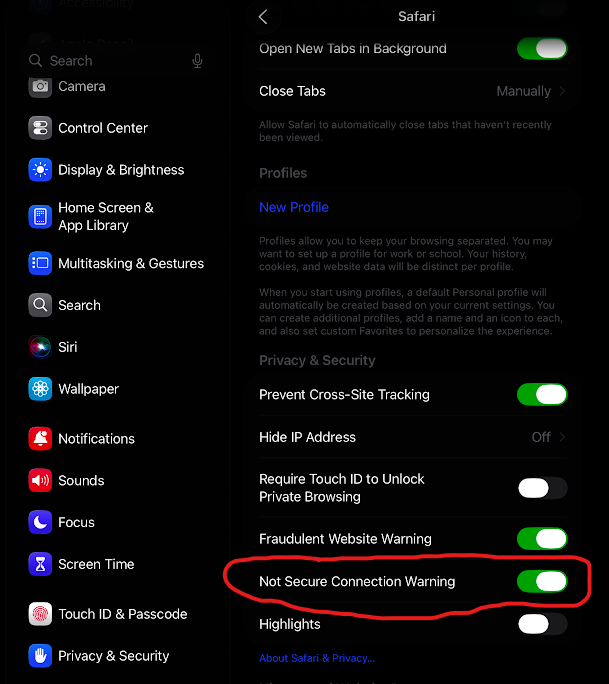

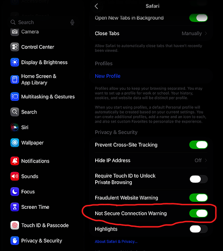

when using the hubitat app under ios26 get a navigation error trying to use http and https only is set. the app fails to connect to the hub due to this error.
There is a setting in your iOS device under Safari browser where you can disable https only. The hub's web interface is http without a self-signed certificate:
