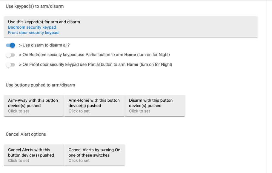

pretty sure @mavrrick58 is right but if that doesnt work if you could do a screen capture of the rule and the trigger and post it as a picture it will be easier to follow. But can't you do this all from w/in HSM by using buttons?
