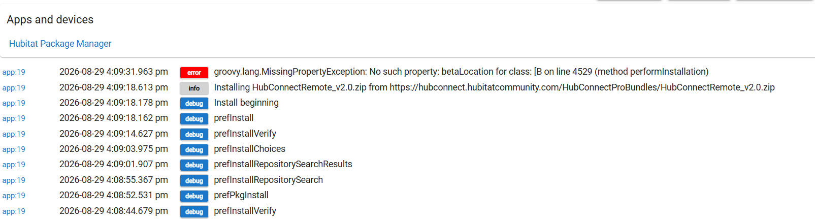

Hi. This is exactly what I am looking for and would love to help test this out. Unfortunately, the HPM installation is failing. Here is the error message I get when I try to install it

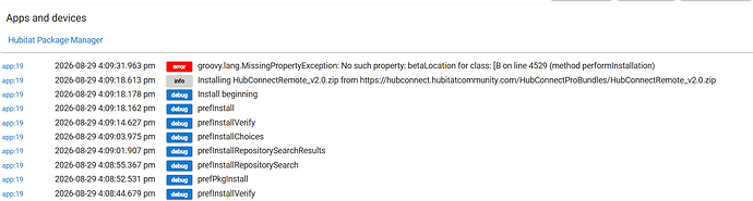

HubConnect has no Beta at this time, the quick workaround is to comment out the check... (add // at the beginning of the line) like I've done here:
But put it back after, otherwise you won't ever be able to install someone else's Beta Bundle. :smiley:
How would I do that? I am not sure what your screenshot is showing.
