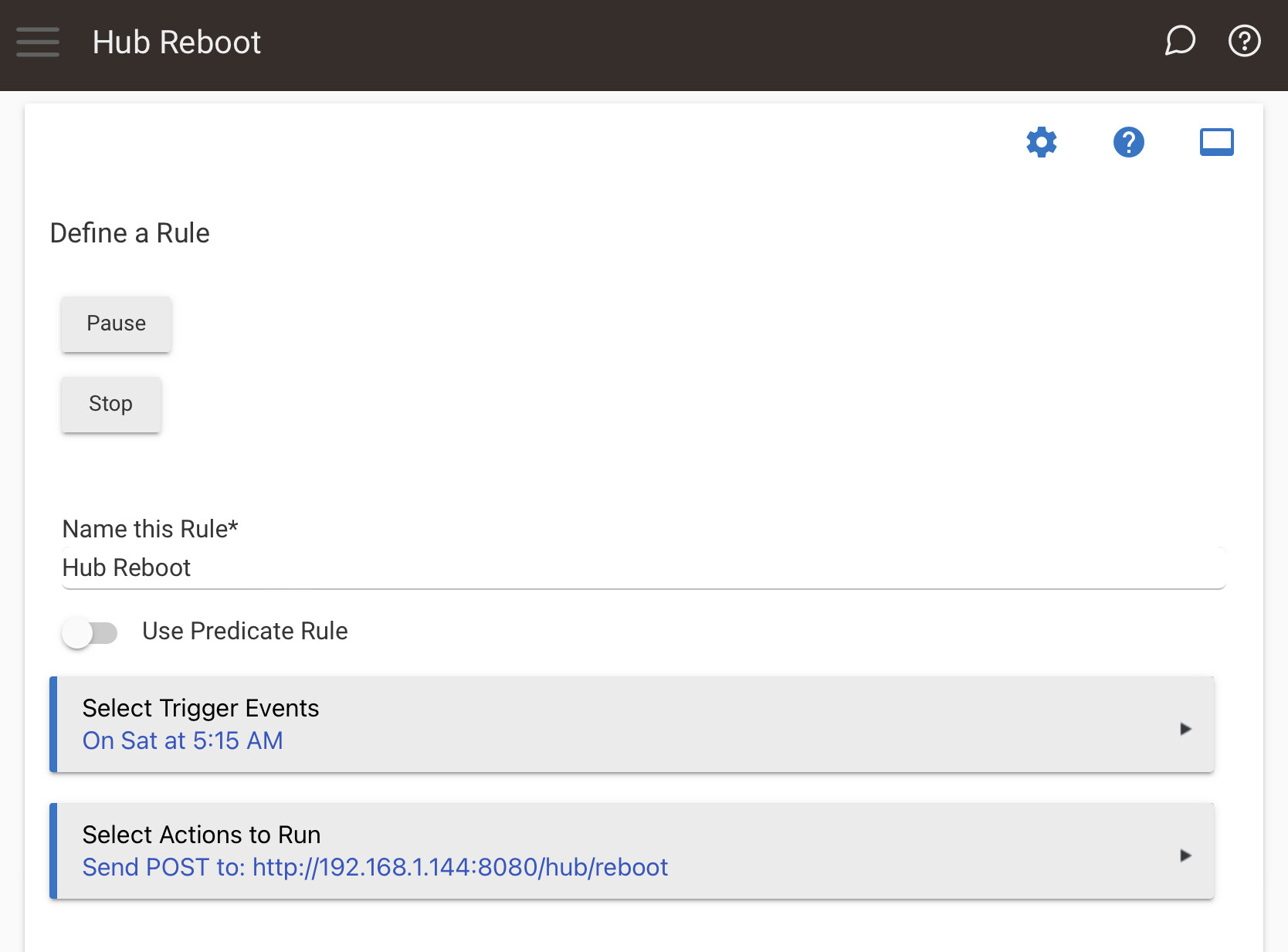

If I program up a spare hub and install it at my cousins home I know it can control devices via Zwave and Zigbee, but what if I want it to do a periodic reboot. How can I program that? Or, if there is a power failure will the hub reboot itself without a router or internet?
Rebooting a hub programmatically is pretty simple. Here is a RM rule that’ll do it.
