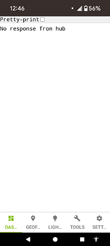

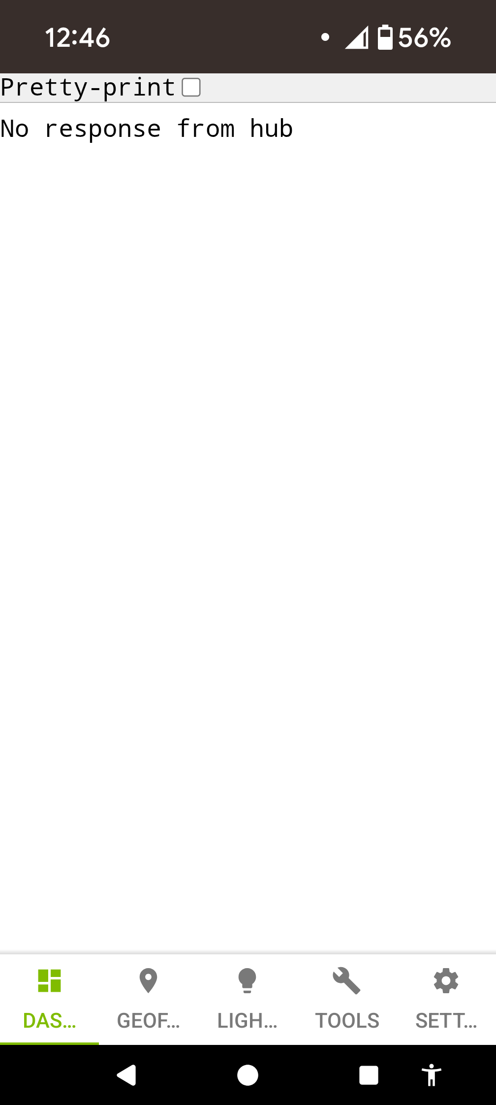

This is what I get when I watch habitat from a browser

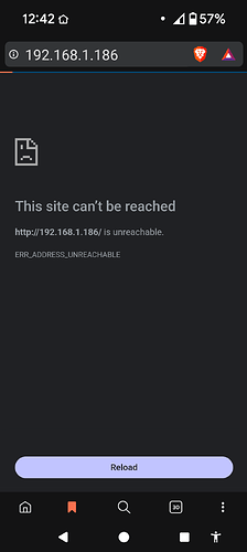

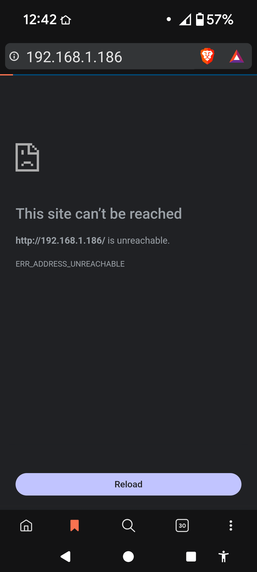

This is what I get when I try to launch the habitat dashboard.
Are you sure that is still the ip address of your hub?

In that case, try http://192.168.1.186:8081
That’s the hub’s diagnostic interface and sometimes it can load even if the main platform interface can’t.
There still comes up with " The site cannot be reached". Basically anything to that IP address gives the same message.
