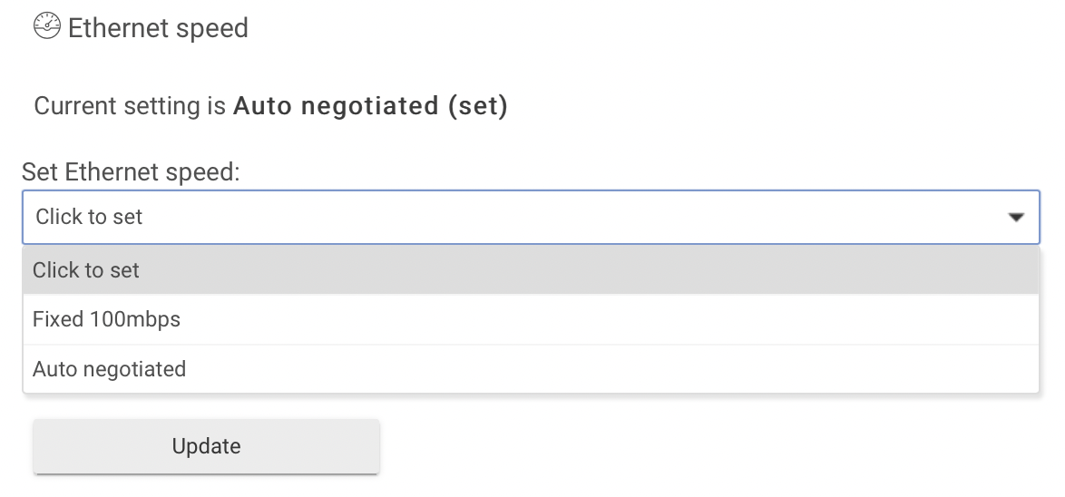

Go to Settings -> Network Setup. Make sure that the ethernet speed is set to be auto-negotiated.

I checked this setting and it was set to Auto negotiated. I remember that when I changed the IP address to 50, I also changed it from fixed 100 to auto negotiated thinking that 100 did not make sense on a gigabit network. So I just changed it back to 100mbps and the interface returned to its normal speed. I am connected to a Nighthawk EAX20 mesh extender. Maybe that device did not like the Auto negotiated. Go figure. Thanks for the help
The interface on the HE is 100mb anyway so you're not losing anything. And that's plenty fast enough anyway.
If you force a speed, you have to force it at both ends. Otherwise, the autonegotiate end will go to half-duplex, and you'll get lots of collisions and unreliable communications.
