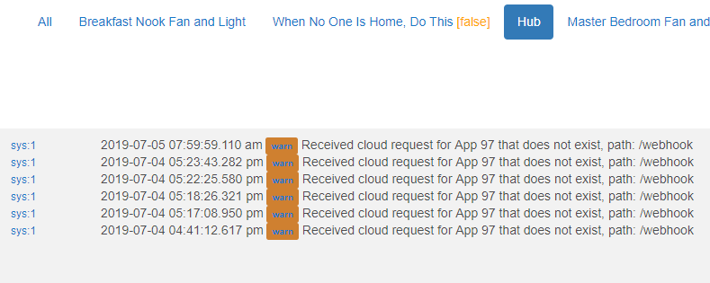

Hub Warning Messages, Would Like to Understand and Prevent
I am assuming that this message is caused by the mobile app. But I don't know for sure. Can anyone tell me what is causing this message to appear and how to prevent it? This is more of a curiosity than an immediate need.
Any chance you have an old IFTTT applet still defined that is trying to connect to your hub? Or something similar? Something is trying to connect via your cloud endpoint connection.
Also, what is app 97? These error/warning messages are "new" in that they were just exposed in the last hub firmware update (the underlying issue itself would have always been happening; now you can just see it). So, I'm not exactly sure, but I'm assuming it's the "installed app" number. In that case, if you try going to http://<your-hub-ip>/installedapp/configure/97, you might be able to figure out more from what comes up (at least whether its IFTTT, Rule Machine, or what). If this is really the internal "app list" number (or if you had the app installed then uninstalled it and it still is trying to use that number), then nevermind. :slight_smile:

These errors were always there, they just didn't show up in the log. The HE team enabled the logging in the last firmware releases to let us track those things down
I bet it is this! Did you disconnect the Life360 integration on the Life360 platform too or just removed the app from Hubitat?

Tried that but all I get is an Error 500 message (Same as selecting the "warn" icon in the message). Which kind of makes sense since the warning is telling me that app97 doesn't exist.

I am sure it is life360, here is debug message that I get when it is installed
app:8392019-07-05 02:08:13.163 pm debugresponse webhook set data: [hookUrl:https://cloud.hubitat.com/api/token/apps/839/webhook?safetimeout=1&access_token=
As you can see, it is calling the webhook endpoint.
