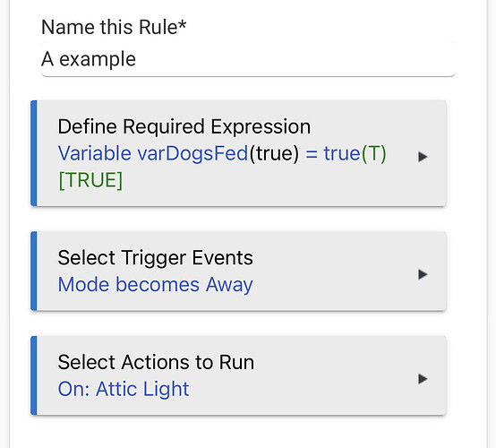

I am new to this coming from ISY.
I have create Hub Variables and want to run rules that say...
Mode Change to Home
and Variable = true
do steps
i can't find a way to restrict with restrictions
what am I missing?
thanks
Mode Change to Home
and Variable = true
do steps
what am I missing?
thanks
You can use a hub variable in a Required Expression or you can use it in conditional logic. Have you read through the Rule 5.1 documentation?
https://docs.hubitat.com/index.php?title=Rule-5.1
I'd start there and post an image of your rule and we can help.
thanks, i found in the variable in the Simple Rules Automation
so much to learn
